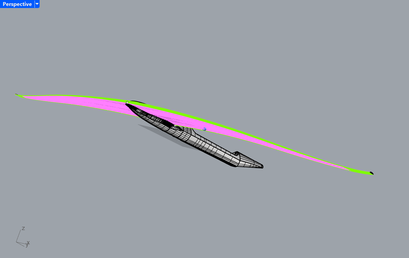

After four complete days I have remade my model in Rhino and joined all curves, surfaces and successfully have a closed poly surface for the 1) wing, 2) Split Line, 3) Mold with zero naked edges.
However, I can only split the mold on the split line, I cannot remove the wing from inside the mold, so my mold is left with a shell of itself on the correct split line.
When I go to split the mold “BooleanDifference” and the wing it says, “Objects do not intersect. Nothing done.”

You need to split the mould with a splitline surface that has no wing shaped cut-out. Then you subtract the wing from the upper and lower mould parts. Also, your surfaces are incredibly complex (huge amount of isocurves, likely overly complex curves).

@Amelia11, The reason your split fails is that you have several vertical rib surfaces within your model and the split coincides with an edge of four of these. (I speculate that you made a half model and mirrored it, but I don’t know how you managed to get them to be part of a closed polysurface without showing non-manifold edges - perhap the model didn’t originate in Rhino?).
If you use ExtractSrf to separate these internal ribs, which are irrelevant to the plug and can be deleted, your split will work. Albeit the front part of the plug will separate into two parts and need joining.
EDIT: I’ve found four more internal ribs, so eight in total need to be extracted and deleted. Actually, once you have removed these you are going to have to _Explode the whole model and rejoin the pieces to get it closed, so Just _Explode, delete the ribs and join rather than _ExtractSrf.

I have looked a little further into your model and you have a problem with the wings. The top surface at the fuselage becomes the bottom surface at the tip and vice versa. Until this is resolved you won’t get a successful mold.

The first thing I noticed was the model is drawing a little funny. It looks like its rendering inside out and all the normals are pointing inward.
The Dir command confirms that.
The polsysurface can’t determine its orientation and I’m not certain that’s a bug. Like others have mentioned these surfaces running down the center should be deleted. Maybe the Join command is stitching them together incorrectly and it just happens to make something it thinks is closed. You’ll have to let us know how you created that.
Like @jeremy5 said the wing surfaces are self intersecting. Both of these issues will cause issues with the orientation calculation.
There also seems to be quite a few edges with very high tolerances. The edge tolerance is basically how far away from the surfaces the edge curve connecting them is. If it’s low the surfaces are joined very tightly. I see a many edges which are quite a bit higher than the document tolerance. There are also a few which are several hundred times bigger than the document tolerance. It’s hard to know how those were created but they can cause issues with splitting, trimming, and booleans. If you run Explode on the object, RebuildEdges, and Join there’s several new naked edges with quite large gaps between them where the edge tolerances were high.
Cleaning those issues up would be a start. I don’t think Rhino should be making geometry like this but you’d need to tell us how it happened.

No, the two surfaces pass through each other about 1/10 of the distance in from the tip. This is illustrated in the images, where one surface is green and the other magenta. This crossover is a reason why Rhino is confused about what is inside and what is outside the object. Obviously this is unintentional as it leaves a line on the wing with zero thickness. How did you model the wing? And, purely out of interest, is this intended to become a wind tunnel model?
