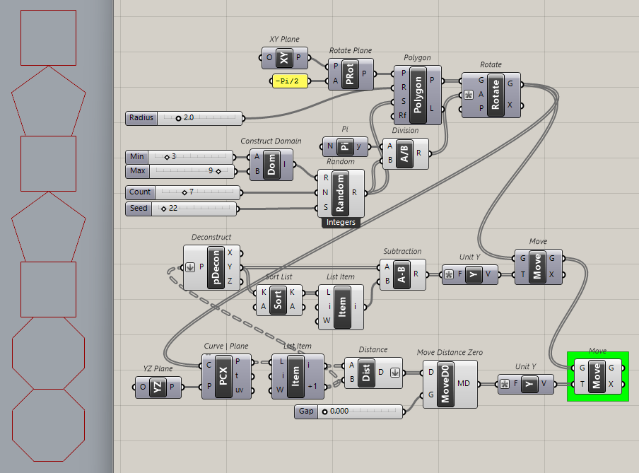

Your code was far too complicated for me so I rewrote it using a MoveD0 cluster from here:
polygon_stack_2025_Feb18a.gh (24.2 KB)
No Rhino file.
Slight simplification by adding two vectors together (one less Move).
MoveD0 cluster is in the yellow group.
polygon_stack_2025_Feb18b.gh (23.5 KB)

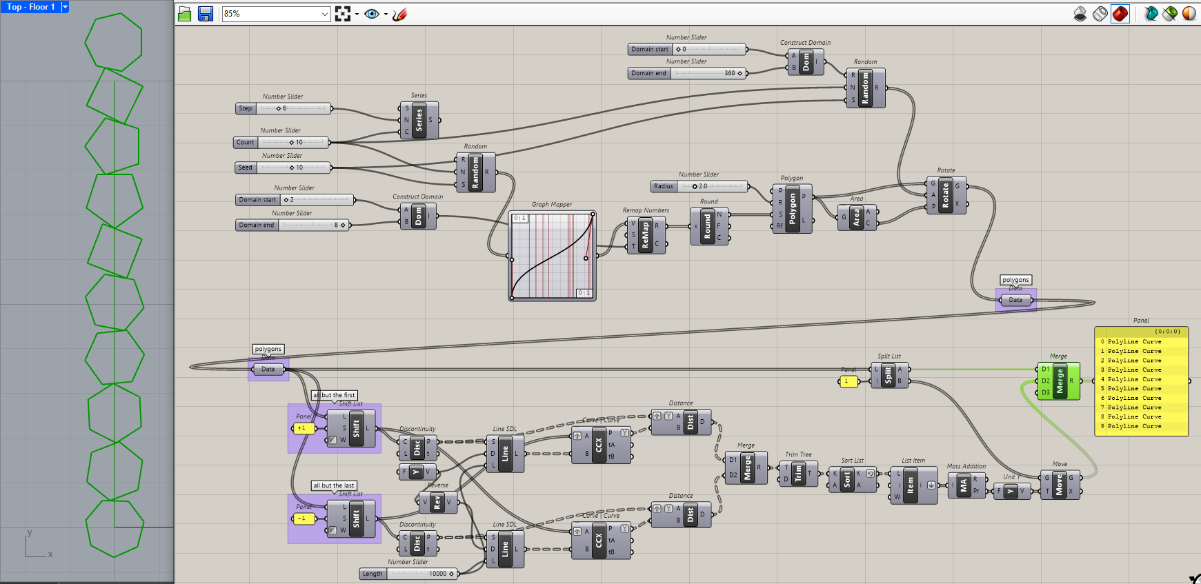

Thanks all. Joseph, is there a way of aligning non symmetrical polygons in a vertical stack. My intention is to imitate irregular plant cells of 4-8 sides and for the line lengths to all be random
Correct @inno , I was really looking for random geometrically aligned forms to touch between vertex and edge closest to vertex not vertex to vertex
I replaced the Polygon component with the white group and can imagine code to close the gaps but first… Is this the right direction?
polygon_stack_2025_Feb19b.gh (25.1 KB)
Added Anemone loop (purple group) to close the gaps.
polygon_stack_2025_Feb19c.gh (33.4 KB)
ok, there’s one important thing to mention tho: this works with the assumption stuff has to always move up (direction +Y) in order to stack (which is the situation you presented)
the two main cases, as you have already recognized in your first post, given two random polygons A and B:
either a vertex of A travels to its intersection with an edge of B, or a vertex of B travels to its intersection with an edge of A:
do we weally care to identify which particular case we are on? I don’t think so :slight_smile: because at the end we have to use just the vector that makes the geometry travel the most (which is the longest vector)
why that?
because if we pick “not the longest vector”, it means that there would be another available but non-picked solution which would prevent an intersection to happen, and because we are not using it → then that intersection is indeed taking place :slight_smile:
so we need to pick the longest calculated vector, which will avoid any other intersection and just leave one vertex intersecting to one edge
after that, just Mass Addition everything and use the Partial Results as Y vectors :+1:
GeometryProblem_Re_Re.gh (25.4 KB)
Replaced some code with orange group. Better and slightly more accurate.
polygon_stack_2025_Feb19d.gh (32.5 KB)
NOTE: The white group implements random radii of the irregular polygons.
