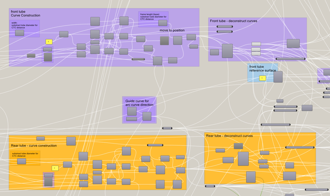

Hi! I’m a big fan of the wires renderer plugin (many thanks 秋水!), it makes my canvases look organised and it is easier to maintain overview. It doesn’t seem to load correctly in Rhino 8 and I understand it has something to do with .NET framework or Core not matching with the plugin’s build. Now my script looks like chaos in Rhino 8. Wondering if the wires renderer can become a native function in Grasshopper? Would be a fantastic future feature

i have installed rhino8 in a new machine and for some compatibility reason wire rendered plugin is not longer working, my massive defintions are now looking like spaghetti monster once again and i am very frustrated.

I love Wires Renderer and experienced the same thing (not working recently). So I vibe coded an emergency solution. This is not as good, but it will cleanup the spaghetti temporarily. Put it in your Components folder and it will be in the Display tab.
HI Declan and thank You very much for asking , i think you did a remarkable job and yes, of course i gave it a try. it works !!! , only 1 thing to report is that wires we doubling when adding relay …i usually make wide use of relay , this is what happen…

This is an interesting solution. Great! Thank your for sharing the sources. It can modify the rendering by subscribing to the “GH_Canvas.CanvasPrePaintWires” and
“GH_Canvas.CanvasPostPaintWires” event. It essentially removes the existing handlers and injects their own. It however requires quite a lot to be replaced and quite deep understanding of the Grasshopper source code. Its technically seen not patching, but it alters the default behaviour in a very odd way.
