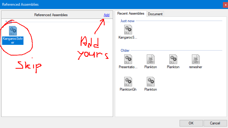

When I try to open this file, I get a kangaroosolver.dll error. Basically, it’s saying it cannot find the reference file (kangaroosolver.dll) and asks me to specify where it is.
Assuming you are using Rhino 5 (?), anyway, if you right click the C# (“Support2”) component and select “Manage Assemblies” you can select the KangarooSolver.dll you have on your machine,
You will probably find it somewhere in your Library folder (Bold text: my folder for Kangaroo in Rhino 5):
C:\Users\ < your name > \AppData\Roaming\Grasshopper\Libraries*kangaroo242_2017-10-25*
Then just drop the existing KangarooSolver and add yours (from the path above)

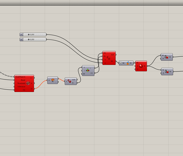

I was able to get the first two errors to go away, but I’m also having errors on other components downstream.
The first error reads
1. Solution exception:Unable to cast object of type ‘Support2’ to type ‘KangarooSolver.IGoal’.
…the second
1. Object reference not set to an instance of an object. (line: 71)
…last error
1. ArgumentOutOfRangeException: Array is empty Parameter name: array
I think the last two errors might disappear after resolving the first one.
I hate to hijack this thread like this.
In the fourth C# component after the Solver (well, it is red as you can see), open the code editor and add a new first row like so:
if (P0 == null || P1 == null) return;
The other errors I have no idea.

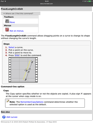

At StF-7 we talked about the native Rhino-command for maintaining a specific curvelenght and I asked you if it would be possible to improve this command using GH and Kangaroo 2, now they are both included in Rhino 6. The old command I mentioned is listed here:
I’m interested since I get the same errors…
The only one that matters is in fact the Kangaroo error: it seems like the Kangaroo solver doesn’t recognize the custom class Support2 created in the C# component as a KangarooSolver.IGoal (even though it’s declared as an extension of a GoalObject): what come out of the C# that creates the Support2 is in fact listed as “Script_Instance+Support2”.
The other 2 errors are simply due to a cascade effect… the downstream components are not receiving as input what they are supposed to due to the error in the Kangaroo component. @RIL wisely suggested an error catch strategy - yet the error remains.
