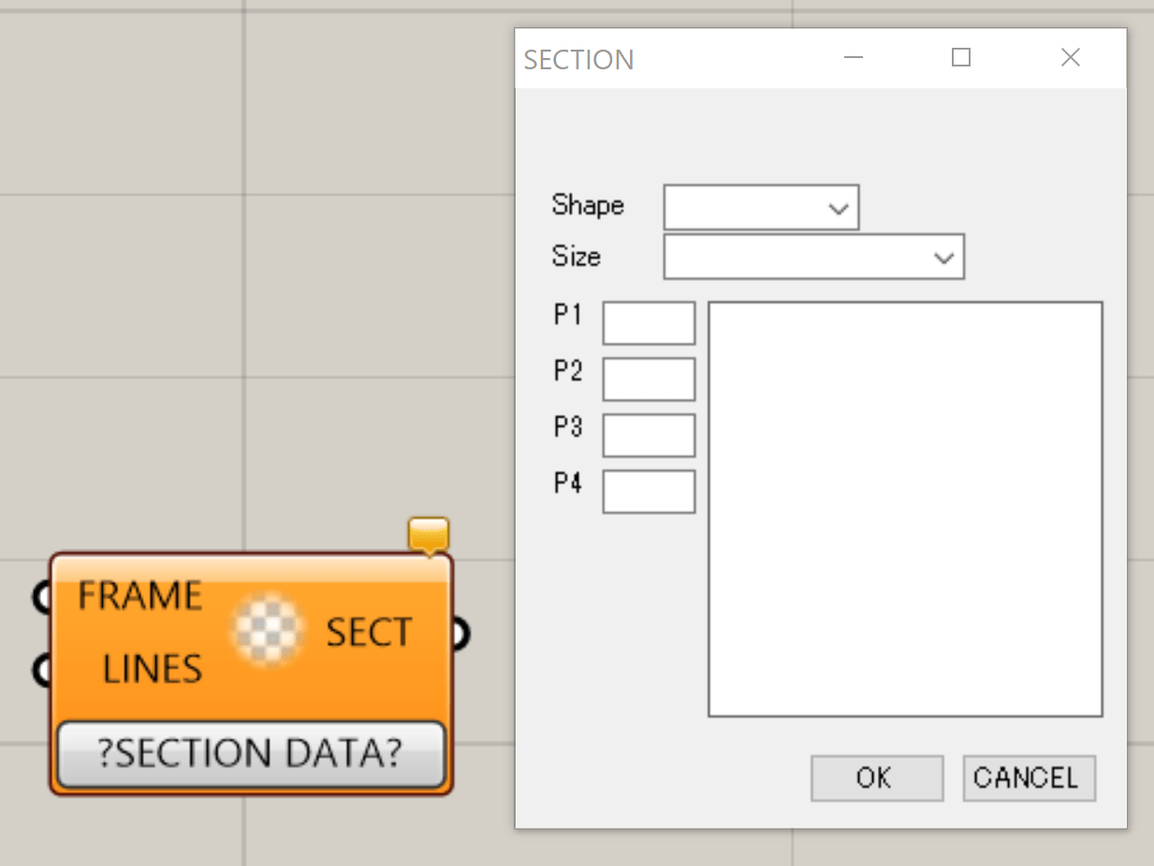

I’m trying to make component which can handle C# forms.
My form will read .csv file when it is showed up.
It works well in Rhino5(both debugging mode and normal launching)
But in Rhino6, my form won’t be showed up.
I found that this error is caused by file location problem.
I usually save .csv file in “C:\Users\UserName\AppData\Roaming\Grasshopper\Libraries”.
In case of Rhino6, Where shoud I put .csv file ?

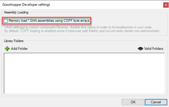

I’m not sure, but sometimes turning off COFF settings could solve such problems. you can do this by running GrasshopperDeveloperSettings command in rhino:
COFF
Hi Mahdiyar,
Thank you for replying me!
I tried this but my problem didn’t change.
