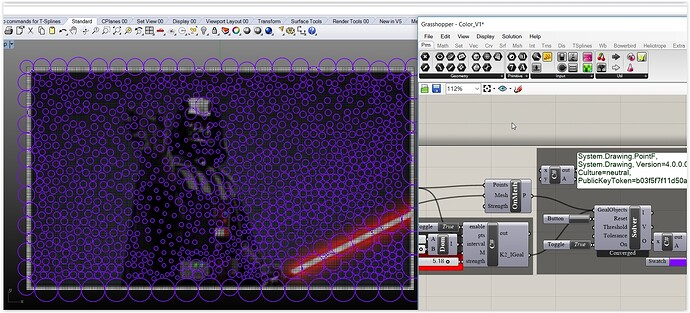

I am having trouble with a C# script in Grasshopper. I keep getting a ‘System.Drawing.Color’ error and I cannot figure out how to fix it?
When I right click on the to “Manage Assemblies” nothing comes up after I click manage assemblies. Any insight would be a massive help!

I am still returning 2 runtime errors I dont understand on the C# K2_IGoal.
I attached a screenshot below. Any idea how I can fix these errors?

Er … hmm … I don’t get it at all (it works 100% OK here, but that is not a strong argument given this weird error on your system):
Line 246 is this:
And the mesh is a quad mesh anyway:
Out of ideas I’m afraid.
