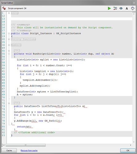

Hey,
I have situation where the C# editor is reformatting and deleting parts of my code. In the first image, the component executes properly when the play button is pressed with the editor open. The code executes properly even when the editor is closed (by pressing the OK button) and the inputs are tweaked. But when the editor is reopened (second image), the code becomes altered and the component fails to execute properly. Lines 75-79 are dedented various times. And in line 78, `mylist[i]` is shortened to `t[i]`. This problem has been replicated on another machine running this code.
 ![200111_1](https://global.discourse-cdn.com/mcneel/uploads/default/original/3X/a/9/a945e2aae1f842956cfe0afe8303edf3a2df5086.png)
 ![200111_2](https://global.discourse-cdn.com/mcneel/uploads/default/original/3X/9/6/9671d10e338004a9ad58bc93e774f3206cbf289e.png)
My datatree problem has to do with the output. The C# component is taking a list from `number` and a list from `dup` and creating a datatree. The component should run twice since each input has two list branches. I was expecting the component to output a tree with six branches (see `desired output` panel). I understand the datatree that I construct in the script is only one level deep. I was expecting the output to automatically tack on a 0 or 1 to the front of the path (like (0;0),(0;1),(0;2),(1;0),(1;1),(1;2)). If it is on me to be more prescriptive about the datatree path, how can I identify which iteration is being executed so I can assign data to a more specific path?

I often see ‘`array[]`’ names being truncated to its last letter (’`y[]`’), or like in your case, to (’`t[]`’).
I’ve seen this happen sometimes when I copy and paste the rows containing the array or list names, but I’ve not seen it due to (re)opening the editor, and not with trees. I think it has something to do with the syntax. Perhaps some new syntax which is not supported by this editor(?)
Unfortunately I can’t read you screenshots (too blurred). Top get more focused screenshots you can press WIN+SHIFT+S and draw a smaller window around exactly the parts that are relevant.

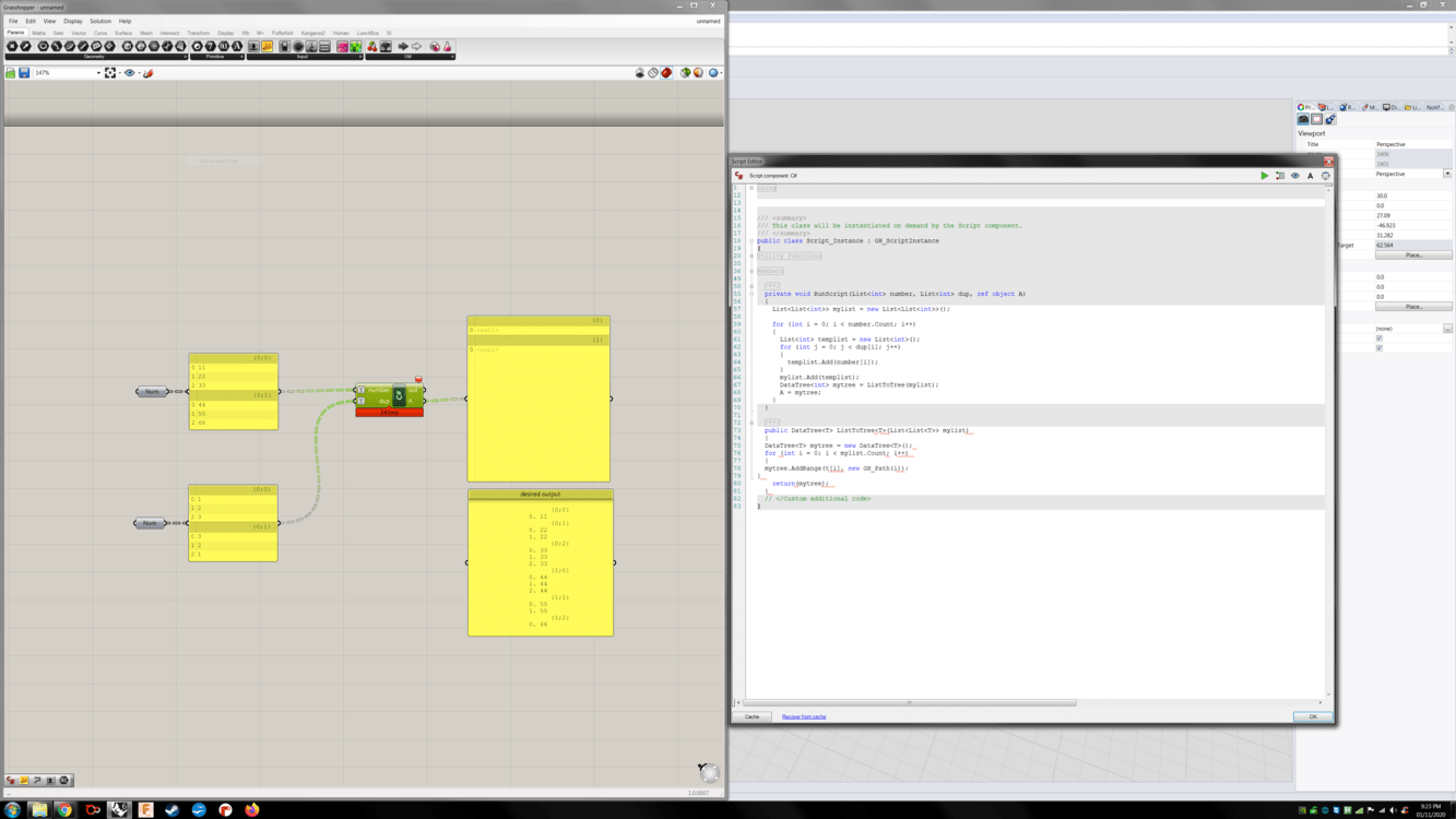

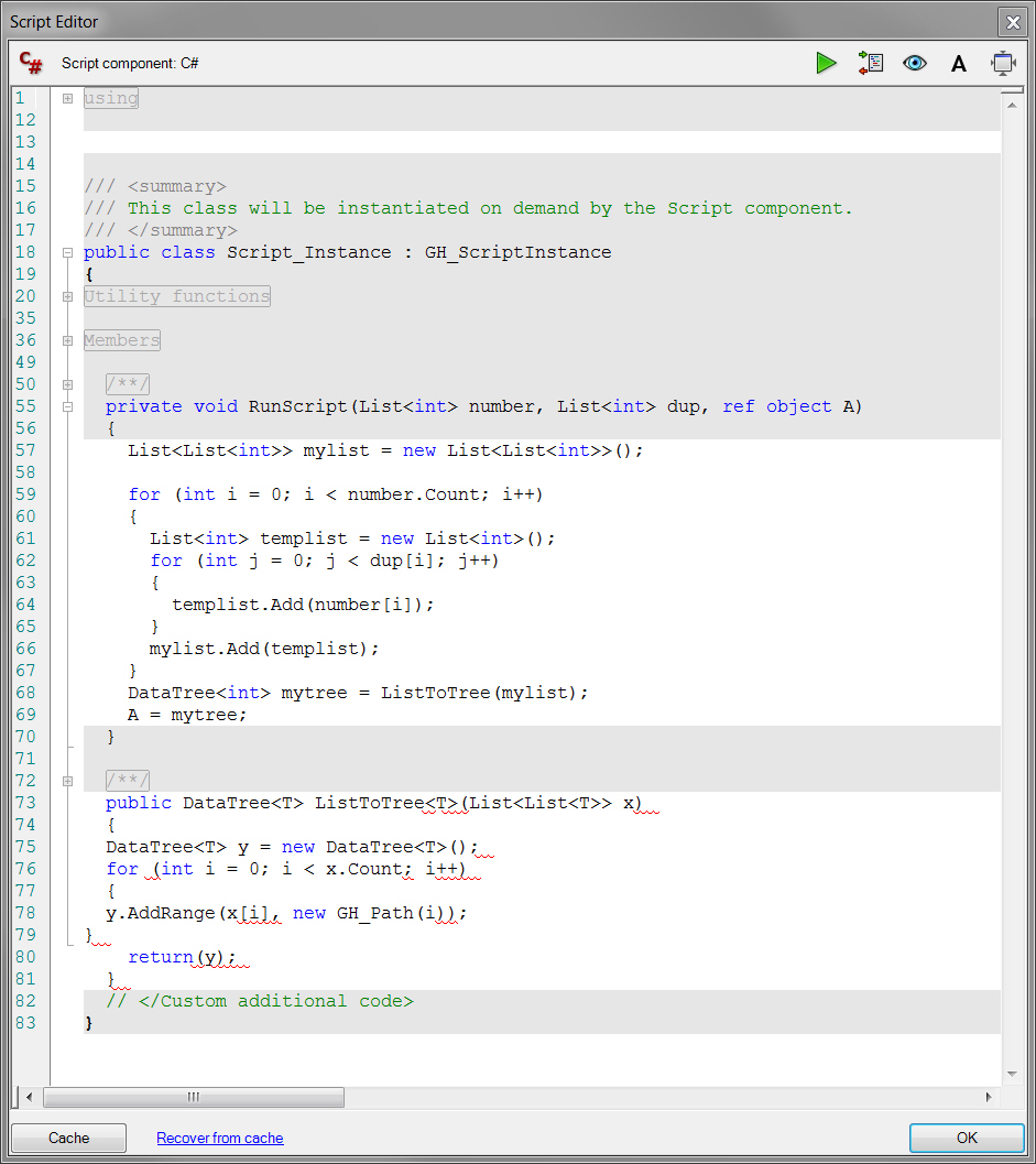

Is it blurry if you click on the image to expand it?
I tried your solution. It partially worked. I changed `mylist` to just `y` , so now it does not change at all. These problems are occuring in my methods section only. I have variables in `RunScript` named `mylist` and `templist`. The code still dedents upon reopening of the editor.
Here are screenshots showing the new code and the new code reopened:
 ![200111_3](https://global.discourse-cdn.com/mcneel/uploads/default/original/3X/0/f/0f248c97bbd9812afd0b13ca7288eb46b98c8085.png)
 ![200111_4](https://global.discourse-cdn.com/mcneel/uploads/default/original/3X/6/7/677b6f2fd0333e5b6b67dbdc286bcfc237a97d72.png)

It is exactly this syntax which causes formatting errors in the ListToTree method. This editor obviously doesn’t support that syntax. But the truncating of array names sometimes happens also when copy-pasting.
![image](https://global.discourse-cdn.com/mcneel/uploads/default/original/3X/8/0/800343a13c7eb8fd39ff98d432f68977bac68068.png)
// Rolf

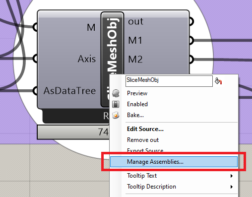

Yes, make a project in Visual Studio and make a class “TreeConversions” (or whatever name) with your **static** methods in it, compile an find the folder of the resulting .dll, place the .dll in your own Components folder and add the .dll to your script component(s) (via the capsule) which needs any of the methods.
I just did that on one of my own script components (I added my own library “ **RILGH\_Geometry.dll** ” to the script component), like so:
![image](https://global.discourse-cdn.com/mcneel/uploads/default/original/3X/c/6/c67ee3b610a6a6b1411a032bd667b2defecedb46.png)
 ![image](https://global.discourse-cdn.com/mcneel/uploads/default/original/3X/e/2/e24cf61d0ccd8946df6091836ca550125aefa29e.png)
I place my own library RILGH\_Geometry.dll in a folder under the Grasshopper\Library (where plugins are located).
