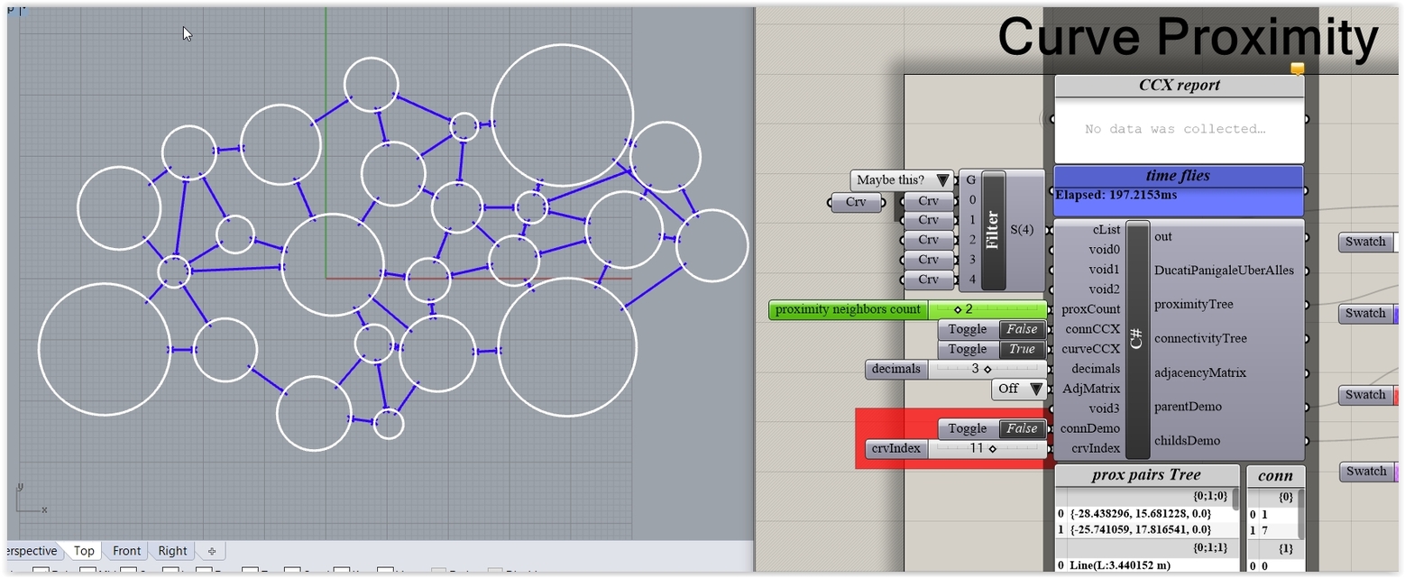

For the proximity … get a genuine post_beach_party C# done this morning. May have some(?) issues (hangover and the likes). This is the by the book (via a custom class etc etc) way to deal with proximity matters. Note the way that connections are done (they are implicitly accessed via indices in their List).
Remember: connectivity is everything, geometry is nothing:
The other C# is written in a great hurry since there’s wind meaning is windsurfing time > I hear the Call > adios amigos.
More soon(?)
Curve_Proximity_BeachInTheMiddleOfNowhereVersion_V1.gh (150.1 KB)
And the post_post_beach_party trad update:
Curve_Proximity_BeachInTheMiddleOfNowhereVersion_V1A.gh (166.8 KB)
