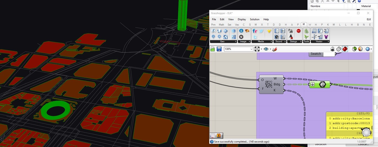

Hi! I downloaded the osm file of the city of Barcelona in Open Street Maps to get the building breps in 3D with the plugin ELK, but i only get two 3d buildings and the rest are planar surfaces. I’m not sure if i’m doing something wrong or it’s a lack of information because i think that the city centre of a city like Barcelona has to have all these height information, but i don’t know…
It’s possible that there is no more height information. What you can do is filtering out the amount of floors, multiply it with a floor height and extrude the 2d shape. But I’m quite sure that there are still buildings left without amount of floors or height information. You can extrude them according the neighbors height or randomly.

Osm is quite lacking on height data, the approach @tim.stark suggests is one I have used in the past and it works quite well (I did this in Berlin -even there almost no height data).
