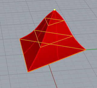

Loft tool, if the 3 2d triangles are on different planes

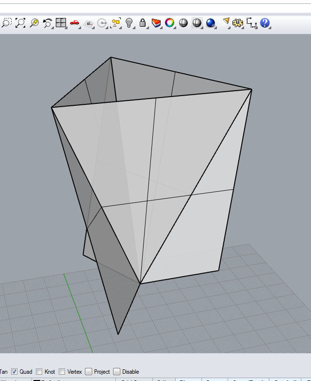

Hi Maarten - are all the shapes triangles?
Hi Pascal,
See here the result.
All the shapes are not triangles but I could work with them as if they where.
I am looking for a way that works like folding paper. Any suggestion?
Thanks
Maarten
