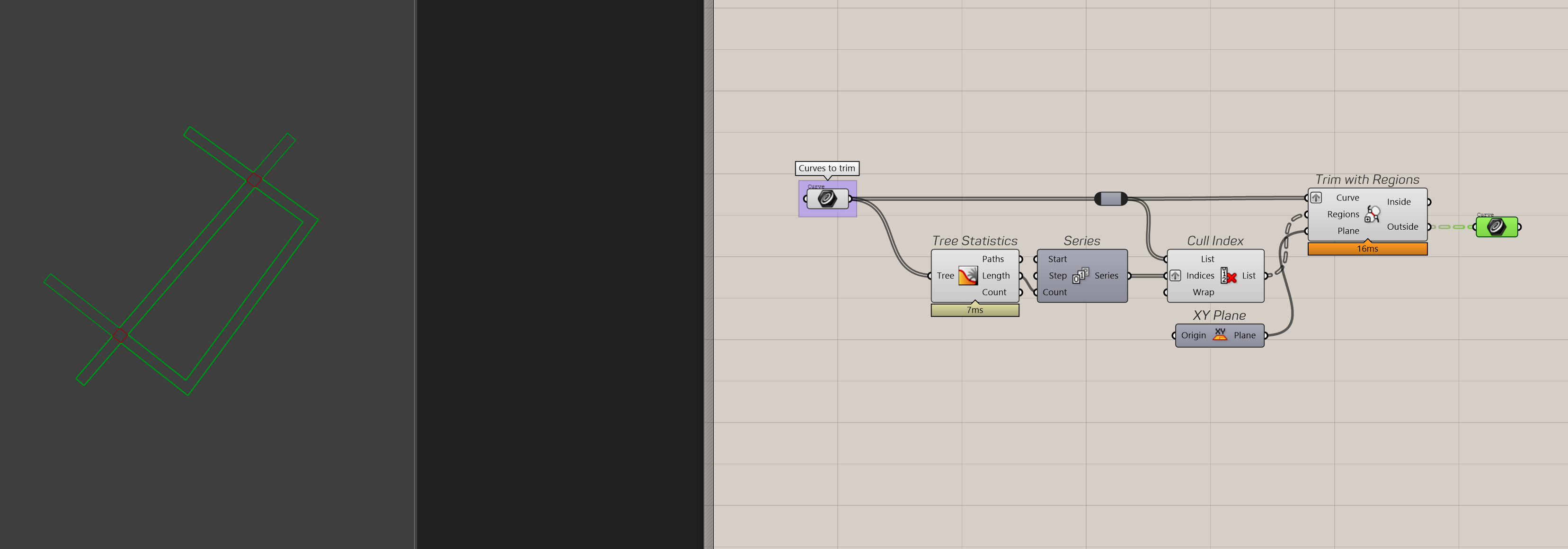

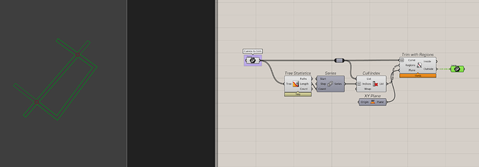

I was puzzled for a while what went wrong with my region trim. I am trying to get rid of the curve intersections between closed curves. Turns out the result in the WIP is different from what I’m expecting.
Rhino 8 (which works as it should):
Rhino 9 (9.0.25161.12305):
As you can see, the WIP for some reason discards parts of the trim and makes the result useless.

Most current WIP (Rhino 9 SR0 2025-6-24), result seems to be correct

Thanks for pointing this out, I thought I updated the WIP, but apparently I only updated R8. It works now.
