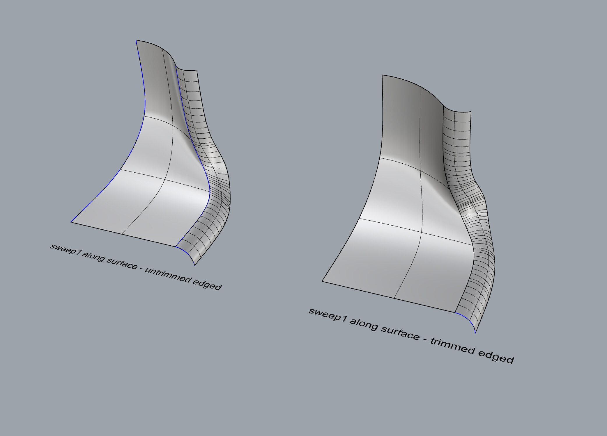

Bug: Sweep1 Align untrimmed Surface Edge
sweep1 - Align Surface Edge
gives unexpected / unintuitive result for untrimmed edges.
(left A)
untrimmed edge:
looks like surface normal + iso-parameter-direction define cross/shape orientation (?)
not very useful result
(right B)
trimmed edge:
edge tangent + surface normal (?)
as expected
sweep1_alignSrf_Bug.3dm (3.2 MB)
this is a bug-Report - (EDIT) find a workaround below.
kind regards -tom

Workaround:
(thanks for the hint @davidcockey )
how to get a sweep1 align Surface Edge for untrimmed Edges:
use
_fin to extend the Surface-Edge … the green stripe, “helper”.
match to a 10x higher tangent-accuracy then you need the sweep1 to be:
_matchSrf (tangent, none, by closest Point = yes, refine = yes, Tangent = 0.1 … 0.01 Degree, make perpendicular to target edge)
_sweep1 along the edge of the green surface stripe
(left with green “helper” - right without)
