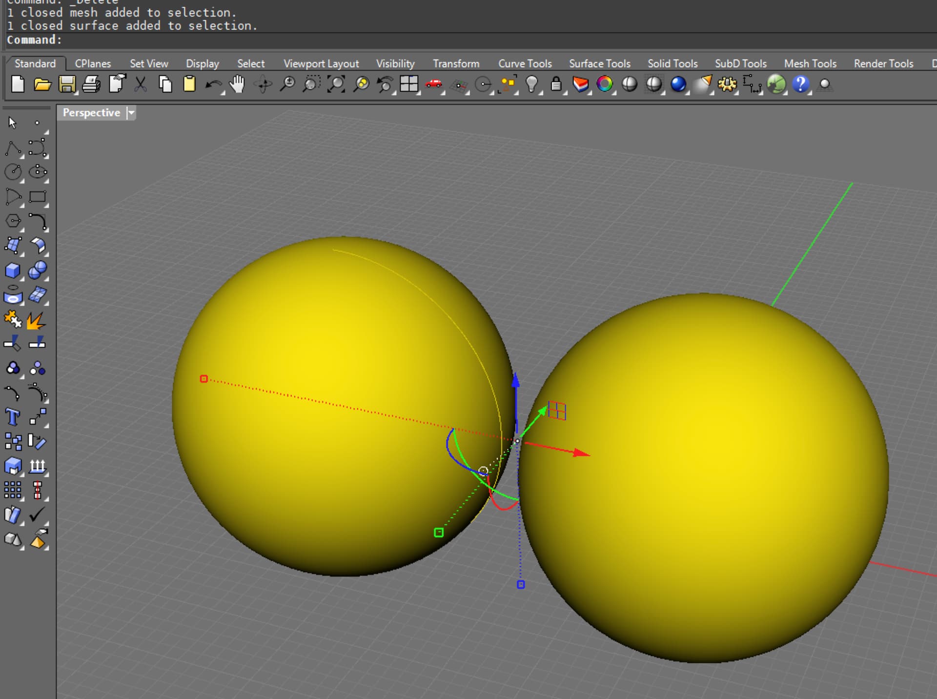

no - its not about the shade selected command, but the display mode property - here some images to illustrate:
This does not work as expected in macOS wip

Good to have that one part clarified, but those pictures are not helping me much in understanding what’s wrong. Clearly, those pictures are from the Windows version. On my Mac, that appears to behave exactly like in those pictures.
here the mac screenshot from the current wip build:

i do not think there is need for that… switch any of the Edge Settings to Single Color and it will start shading the mesh edges no matter the display setting:
I see that, but I see that across all versions I’ve tried (6/7/8), while you mentioned in the start of this thread:
So the bug you report is actually only your last image of the settings, is that a correct conclusion?
sorry I am not sure what you mean?
On Windows the setting on the last image does NOT override any mesh wire display. All wires are off, when the viewport panel has mesh wires set to off.
On macOS - the settings in the last image override the viewport panel settings.
There is no way to hide mesh wires when selecting an object (that is the issue!)

you are right! - it is also in v7/8 windows… mixed it up with surface edge override
