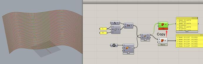

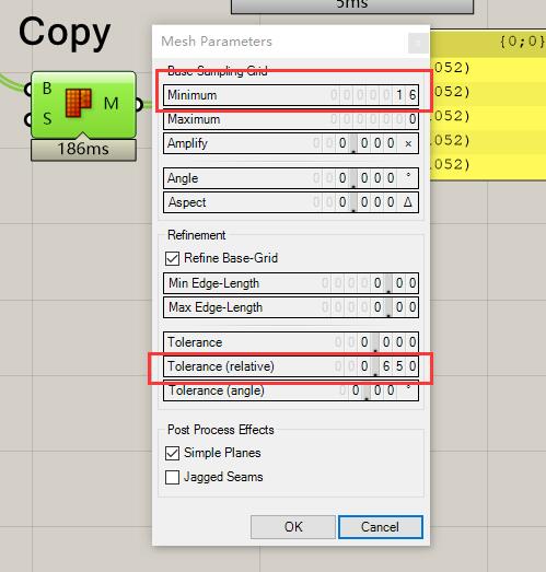

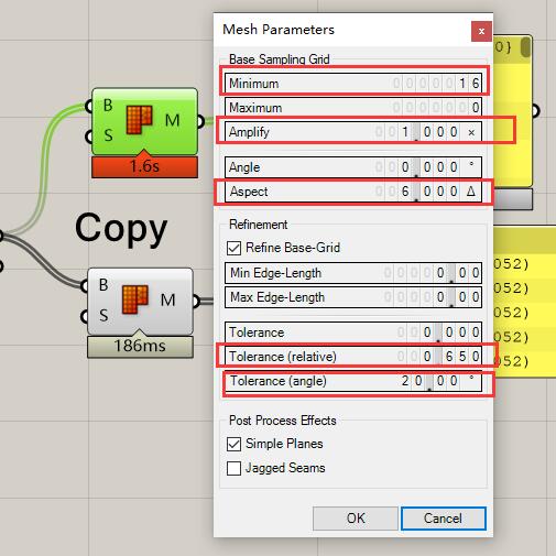

This problem also exists when copying the “Mesh Brep” component.
Mesh Brep.gh (8.3 KB)
