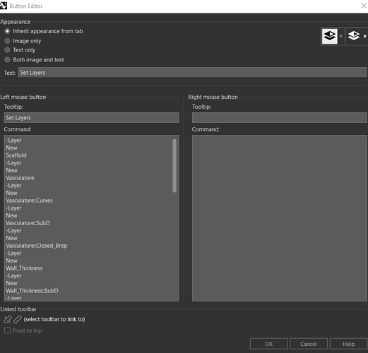

Discovered some bugs and weird issues:
  1. When editing the Macro or the image, Rhino crashes when i hit “apply”
  2. I can get the button edit to work, by deleting the old one, and make a new one, by filling in the edited content in the Button form.
  3. BUT … now the _Direction interchanges between _Cplane and _View, when i either left click or right click
So the button is kinda useless, because i can not really be sure what direction is set, and I would have to open Settings>ModelingAids>Nudge and make sure the Nudge Direction is set to “Use View Axes” and then it would change again, next time i use the button…
Please check this bug out, thanks :slight_smile:

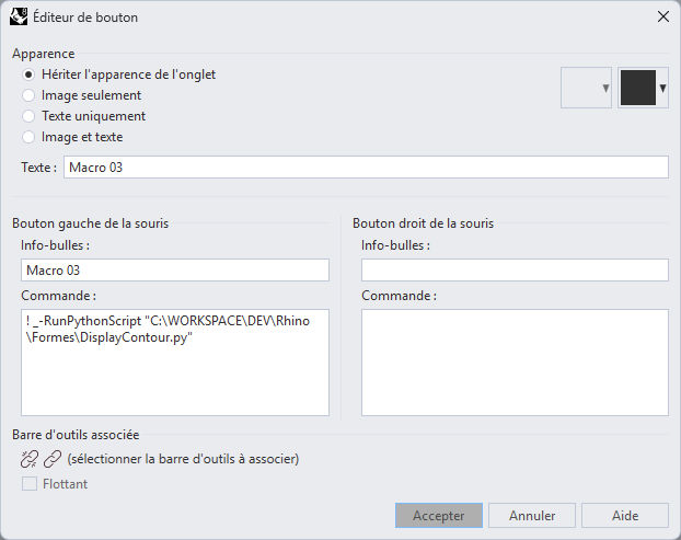

See the screenshot above, Rhino crashes when “Accepter” is clicked :
Current version installed is : Version 8 SR15 (8.15.25019.13001, 2025-01-19)

Hi, same problem here on 8.15.25019.13001, 2025-01-19 (Win 11)
Like @N.L I just call a .py file and I need to change directory.

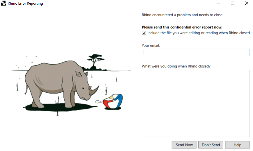

It crashes every time I hit “Accepter”… I have send the report.

@gijs For me, when I try to edit anything on the button, Rhino closes. I tried on another device and another license and the same thing happened. I’m directly on Rhino and I’m not using Python.
Yes, it does the same with the 2 files I’m using.
It work fine on the machine with witch I made the button, once I open the .rui file on another machine and try to change the path in the button editor, it crashes on saving.
It does also crash on the original computer I made the button with on path modification.

I have the same problem in 8.15.25019.13001 and it crashes with every butten, even when only changing the appearance from Inherit from tab to Image only (and the tab appearence is Image only anyway)
when I press ok it crashes, even without editing, is a button that I created
@Clara_Andrezzo I hope you’ve sent in that crash report. I managed to crash Rhino with the settings file that @Ronan.P sent, though it crashed differently. It would be very helpful if you could send your settings zip as well.
This issue is resolved in 8.16 and might be related
RH-85305 Toolbar: Crash when editing toolbar button
@Ronan.P @N.L @Clara_Andrezzo See if the Rhino 8.16 Release candidate fixes this issue for you.
