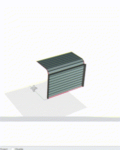

Bug: Disappearing Model when panning/orbiting. New in recent releases?
Refer to GIF: As I pan/orbit my model(s) disappear. It does it in some files but not others.
Disappearing Objects Glitch
X-GARAGE DOOR.3dm (4.4 MB)

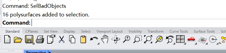

I found 16 very strange polysurfaces in your file. If you hide them, the issue you reported will not occur, as shown below.
I’m still investigating these odd 16 polysurfaces :joy:
I found they are bad objecsts,
I selected them and deleted them and the problem is gone. But when I selected them I couldn’t see anything selected but I could delete them.
Either way problem fixed thank you!!
