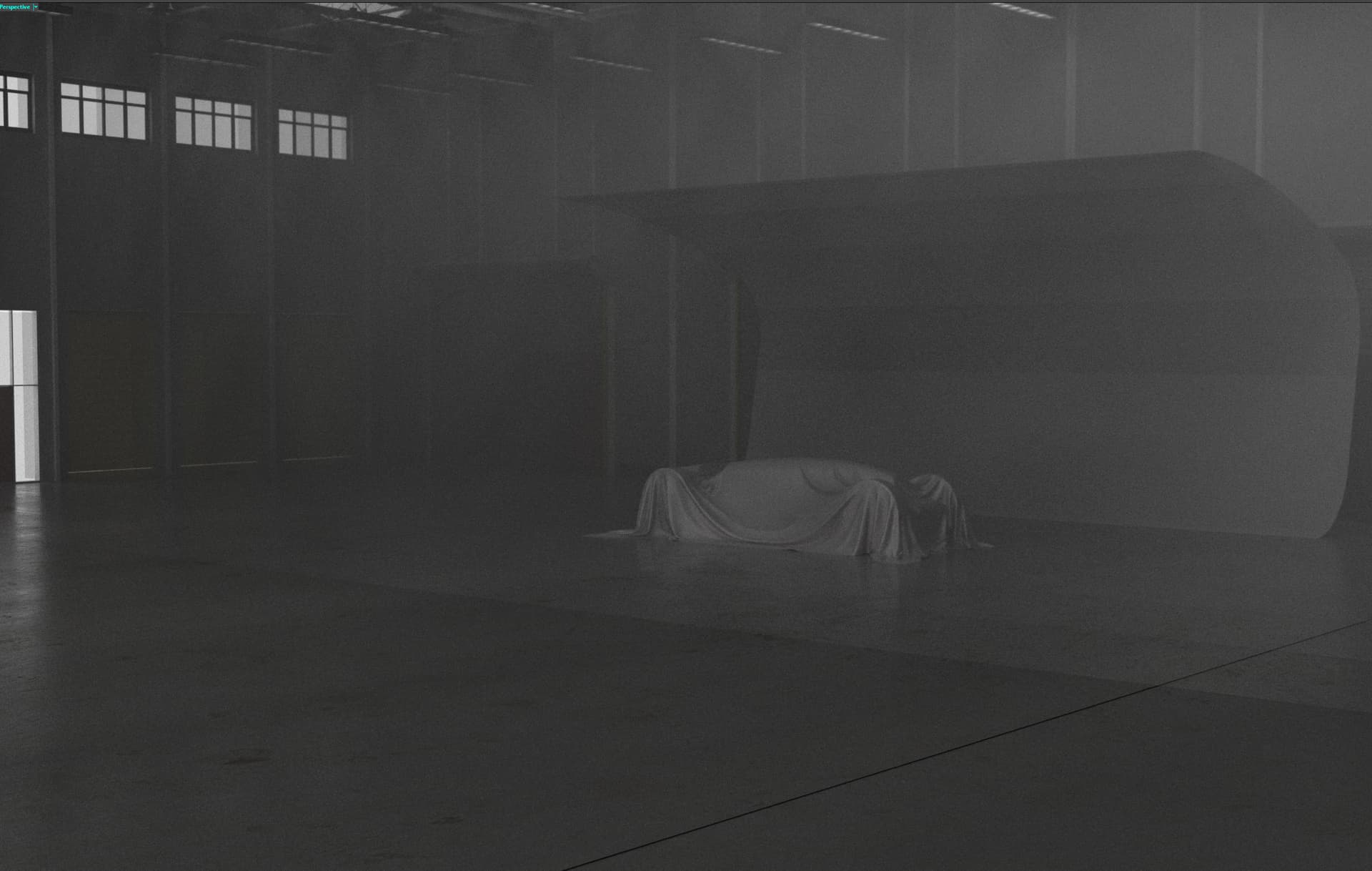

Allow me to introduce… fog
Breathing Rhino Cycles; unexplored direction - Fog Rendering.
A hard start
Inspiration from the visionary work of SkyG and giving it a spin.
He used to say “such a journey!”.
“They will end up hiring us lol”
So why rush, enjoying the process takes time.
Last Tutorial: 2019 GOGO Rhino 7 Tessellation Research

Thanks Kyle! I notice that I can’t go down lower than the 0,01 value in PBR Opacity transparency. And that is way too high. I wish for more fine tunning.

The PBR Fog Air Material
I achieve that by putting an array of surfaces with transparent material.
Here is another more clean version
This was Rhino7 no Cycles X
cool, that was on my to try list using an volume, before i experimented with actual particles produced in grasshopper, but that was way too heavy.
but i am not sure i understand correcly, did you slice up the room with several planes, or did you use a volume?

Is this the volumetric in Blender?
nathanletwory
(Nathan 'jesterKing' Letwory)
July 1, 2023, 3:47pm
11
Probably just geometry with materials that have opacity turned low.
He’s just slicing up the room - pretty simple really!

I showed this technique back in 2020 in this reply:
Until we support volumetric shaders you can pretty easily simulate them with actual geometry though. Here a very quick setup:
[image]
volumetric_cheat.3dm (581.6 KB)
With some extra work on the material you can bring some extra depth to the effect, like maybe with a gradient on the alpha channel.
