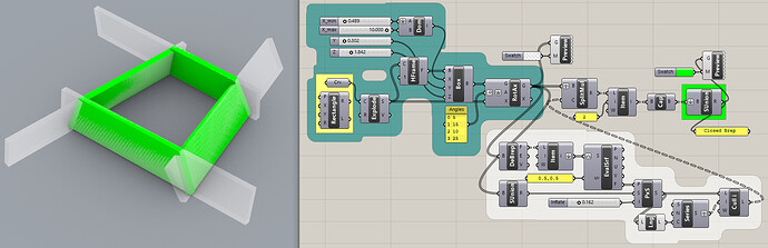

This is a somewhat elaborate effort to intersect, trim and combine four overlapping breps to make a shape similar to yours (without the holes and bumps you have). There is a text panel list of “Angles” that apply to each side and the ability to have a trapezoidal (non-rectangular) shape.
irregular_sides_2021_Jun24b.gh (23.3 KB)
The white boxes are created in the teal-colored group (top left) but could be created in other ways. .The outward faces are used as the basis for PxS (Plane Through Shape) cutters used to trim the breps. Then Cap Holes and SUnion are used to make the final shape (Closed Brep, green group).
irregular_sides_2021_Jun24b4
Thank you Joseph! It works perfectly. I have learnt two new commands Pxs and SplitMulti :slight_smile:
