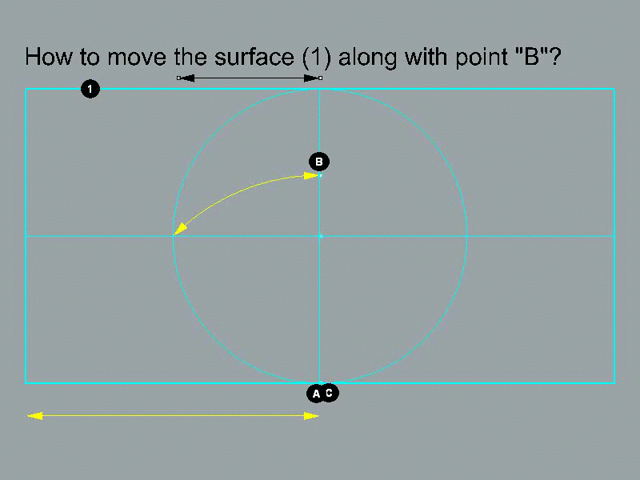

Bongo: How do I slide the surface along with point B?
Hi Bongo experts,
How do I make the Surface (1) slide along with pt “B” without rotating or following the arc-like path. I want the surface to slide along the X-axis only (orthogonally), half the travel distance of pt “A”.
Edit: Forgot to say that this movement must work in both left and right directions (so IRL, the contact point B is a pin sliding in a (vertical) groove in surface 1, forcing the surface to slide left and right) :
The model
0_SlideSrf_01.3dm (102.0 KB)

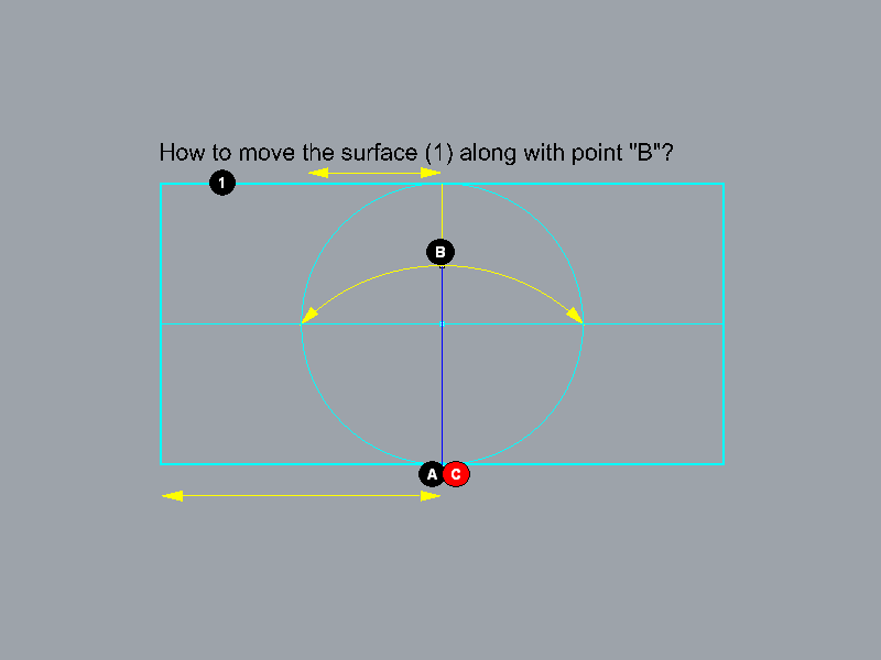

@Luc,
OK, I found one solution (the surface, being a child of telescope T_x, now moves half the distance of pt A), although the configuration feels a bit over-complex(?)
I could simplify a bit after I made this gif, by removing the line B-C and point C, since they are not needed if constraining the point B to follow the green arc.
The telescope T_y is constrained to pt B, and T_y is also a child of T_x :
Pt B doesn’t seem to be following very strictly though, since it looks like it “lags” behind a bit (why is this?)

The easiest way to make an object travel half the distance of a another is to use an Expression.
In 0_SlideSrf_01 Expression.3dm (119.1 KB) the Expression #PT_A.PositionX#/2 is applied on Position X of the surface (SRF). Note that ‘Space’ must be set to ‘Object’ in order to take the basic location of the surface into account.
When you are determined to use IK the problem is to find a way to keep a child of object “PT_B” in vertical direction.
A kind of shrinking setsquare can be used: 0_SlideSrf_01 IK.3dm (125.0 KB). The setsquare is formed by 2 auxiliary points and the surface’s pivot forming a right angle and kept in line by means of a double constrain. The shrinking is needed to compensate the variating distance between object “PT_B” and the surface.
An alternative is to use a secondary chain which is attached by a Simple constraint ‘Object To Pivot’ to “PT_B”: 0_SlideSrf_01 OTP.3dm (121.5 KB)
Other than a parent/child relation this Simple constraint only takes over the Position of PT_B but not its direction or scale.
