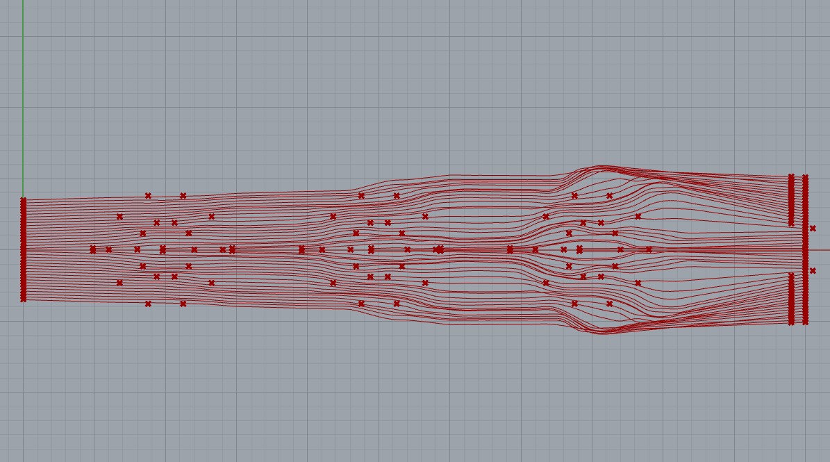

It’s been a long time I haven’t done something cool with grasshopper so I looked at my old projects and found some interesting things I’ve started years ago, in 2016… time passes…
So I decided to recycle some code I did with the Boids plugin and I remembered this old post
First I started to play with Pablo Miranda’s code, the result was satisfying even if I still understand half of it… for now. But when I tried to redo the code… things got messy.
Actually, the old mathematical components doesn’t work like the new ones so the loop doesn’t work at all…
If someone can look at the codes I’ll be eternally grateful :wink:
This is the result I’m trying to achieve but it in the xz plane…
