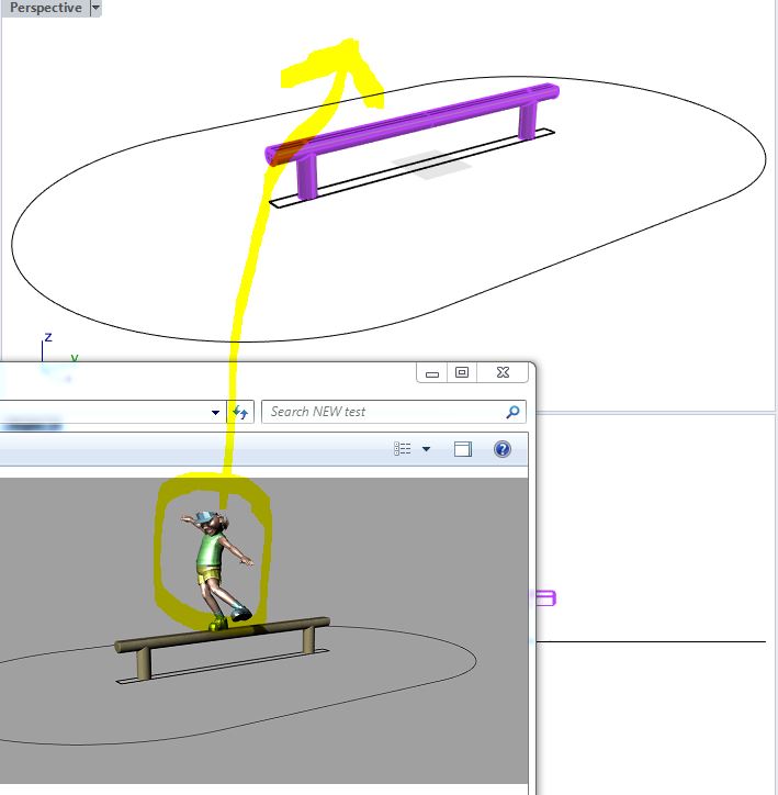

When I try this with them set up as Lands blocks however, these linked blocks inside the Lands blocks just do not import.
Is this something that is a known limitation, or am I missing something somewhere?
Lands object consists of a b2d, b3d, jpeg and txt file. Within the b3d model, there is an additional linked block, this is the one that doesnt import.
Image below shows the windows explorer browser and also the Lands window with the imported block missing the person.

I’m doing some tests and I haven’t detected any problem during insertion through Lands commands. Nested blocks are there. What I see is that linked blocks are drawn when is Rhino who draws the block that contains them. If you use the same block in Lands Objects (for example as plant 3d display), then is Lands who draws the block, and it looks like it ignores any linked block contained in it.
However, since in Beta IX urban furniture blocks are standard Rhino blocks (not Lands Objects), drawn by Rhino, you should be able to see linked blocks. Are you using the Row object to insert them? Rows are Lands Objects (custom drawn objects).
Anyway, “linked and embed” blocks should work perfectly in Lands Objects, so I recommend you to use this option when you nest blocks, instead of “linked” only.
