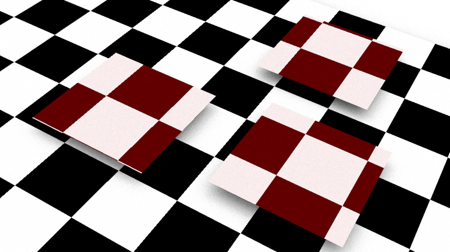

Hi Brian,
I was probably not expressed myself correctly, I wonder whether is it possible to keep the geometry of the block and modify mapping on each copy of the same block instance? Something like this so you avoid repeating pattern on each block copy:
Hmm- looks like we need ‘By parent’ texture mapping!

Hi Violine- I don’t know if it is feasible, or even what I suggest makes any sense to the programmers, it just feels about like a ‘By parent’ setting to me.
maybe @andy will have a real idea.
It’s actually really, really tough to do. However, for this particular example I would suggest using WCS mapping.

At the current point in time, WCS is your best bet to deal with it quickly.
For Blocks, no way without McNeel upgrades as Blocks are always looking at InstanceDefinition and here Mapping would have to be decoupled from the underlying geometry which ain’t that easy as Andy said - designing such structure is already a headache. Though it is a good question if it is doable someway around I would need to check if there is any workaround route - most naive I can think of now would be creating some finite number of blocks with auto shifted mappings each then juggling them.
