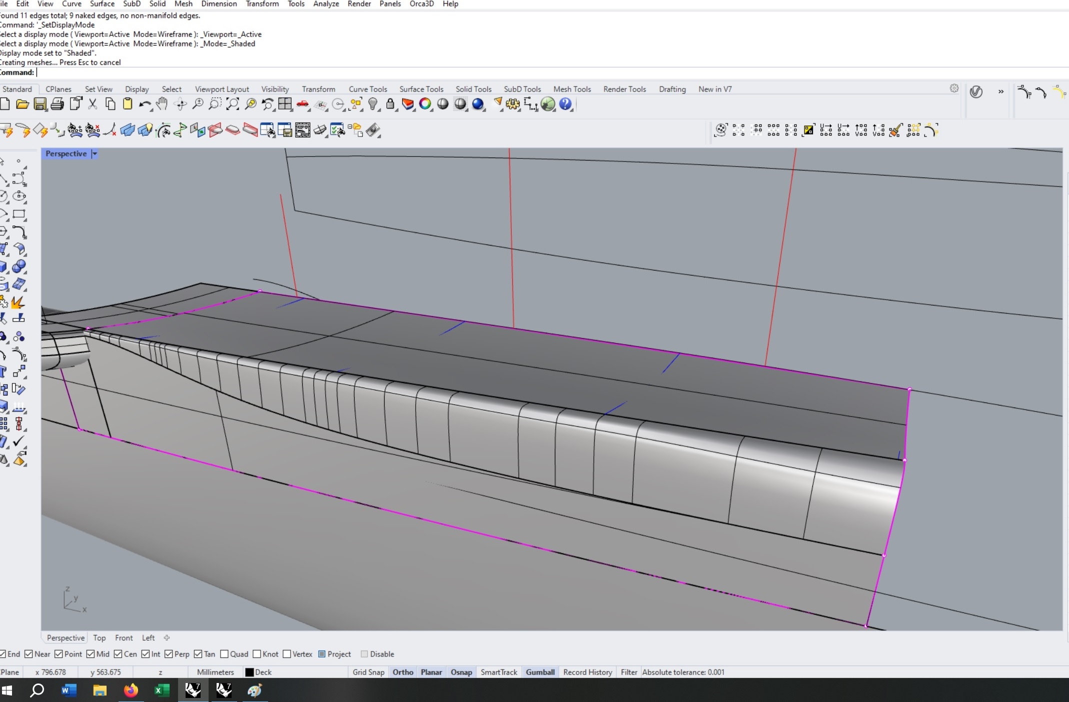

Hi. I’m on Rhino 7, been using Rhino happily for many years.
Just trying to blend two surfaces, one of which is trimmed. Blend is created looks fine. If I join the two surfaces and the blend, there is no naked edge which is great. All bread and butter stuff.

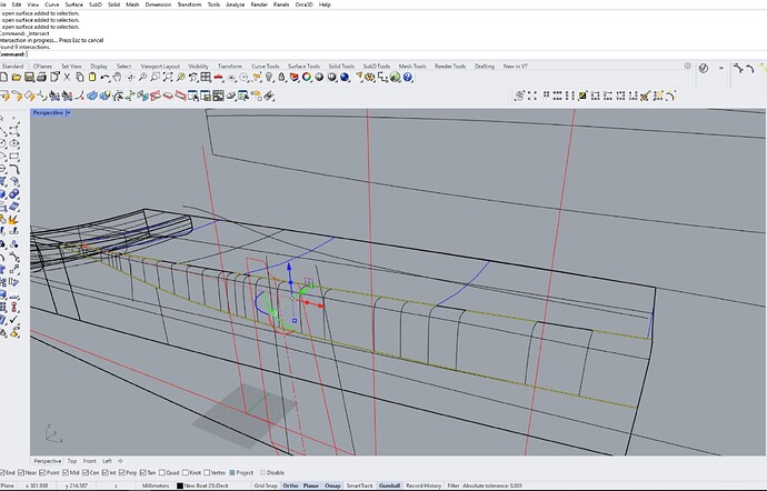

If I don’t join but ask the perform the intersect command, I’m getting a broken line (highlighted in yellow).
I pretty much always check blends with intersect and have never had issues that I can’t fix logically.
Feels funny to me that the intersections largely start and finish at isocurves.
Trying to bug check, messing with Rhino unit settings doesn’t seem to cure it.
The surface throwing up the intermittent intersection is not trimmed, doesn’t have anything clever like different point weights etc so for me should be easy to run this blend along.

May something have changed? Should I just not worry because if it says no naked edges when joined that is the acid test for downstream machining etc?

Using Intersect to check if edges of adjacent surfaces are close is new to me. My guess is that is not an intended use of Intersect.
To check the deviation of surface edges I use CrvDeviation and select the two edges to check. Doing so on the upper edge of the blend surface and the adjecent edge results in:
Maximum deviation = 2.26898e-12
For the lower edge:
Maximum deviation = 8.66707e-13
Those results are in the numerical roundoff range. No problems.
You can also use EdgeContinuity to check the deviation between adjacent edges.
If Join results in no naked edges then the maximum deviation of adjacent edges will be less than two times the absolute tolerance. (If JoinEdge was used it’s s a different story and it can cause problems downstream.) So that is usually the test for whether the result is a closed surface for manufacturing, assuming the absolute tolerance is appropriate. The usual suggestion is the absolute tolerance should be about an order of magnitude tighter than the acceptable manufacturing tolerances. The absolute tolerance in this file is 0.001 mm which is around 1/100 of the diameter fo the average human hair, so it should be more than tight enough for a boat.
