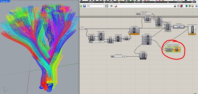

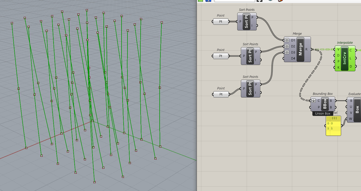

I’m working on a tree-like structural component and I have a series of lines that I’d like to convert into strips to form a solid section — ideally something that resembles a Voronoi pattern in cross-section.
The idea is to use timber strips, so the final geometry should be a buildable solid rather than just curves or surfaces. I’ve tried using Loft and Sweep, but then I’m not sure how to combine all the strips into a single solid, since Solid Union or Solid Difference only works with closed breps or meshes. I was also thinking on inflating mesh pipes until they collapse with the others but I think its a bit heavy.
Has anyone done something similar or has an idea on how to approach this? I’d really appreciate suggestions — even better if it’s something that could work well for fabrication!

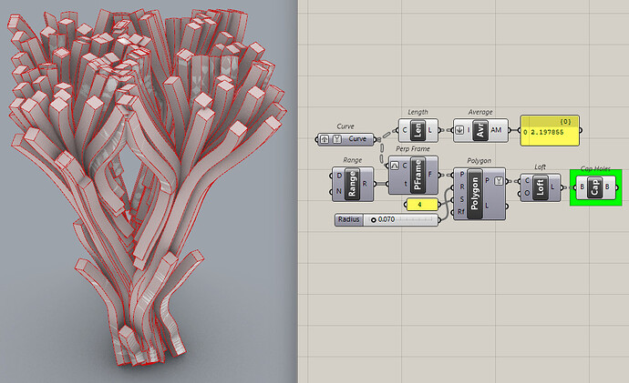

These are all closed breps but SUnion (with flattened input) fails.
I used Loft because Sweep1 failed.

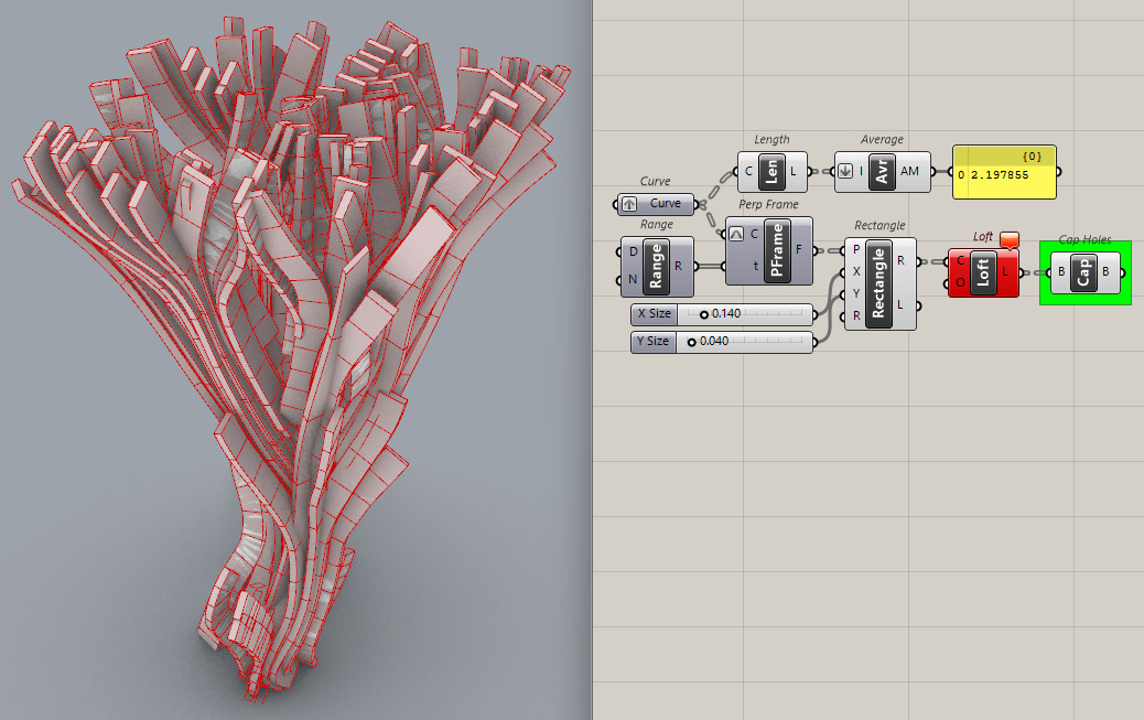

P.S. Using Rectangle instead of Polygon, one curve fails,
STRIPS_2025Jun12b.gh (362.8 KB)

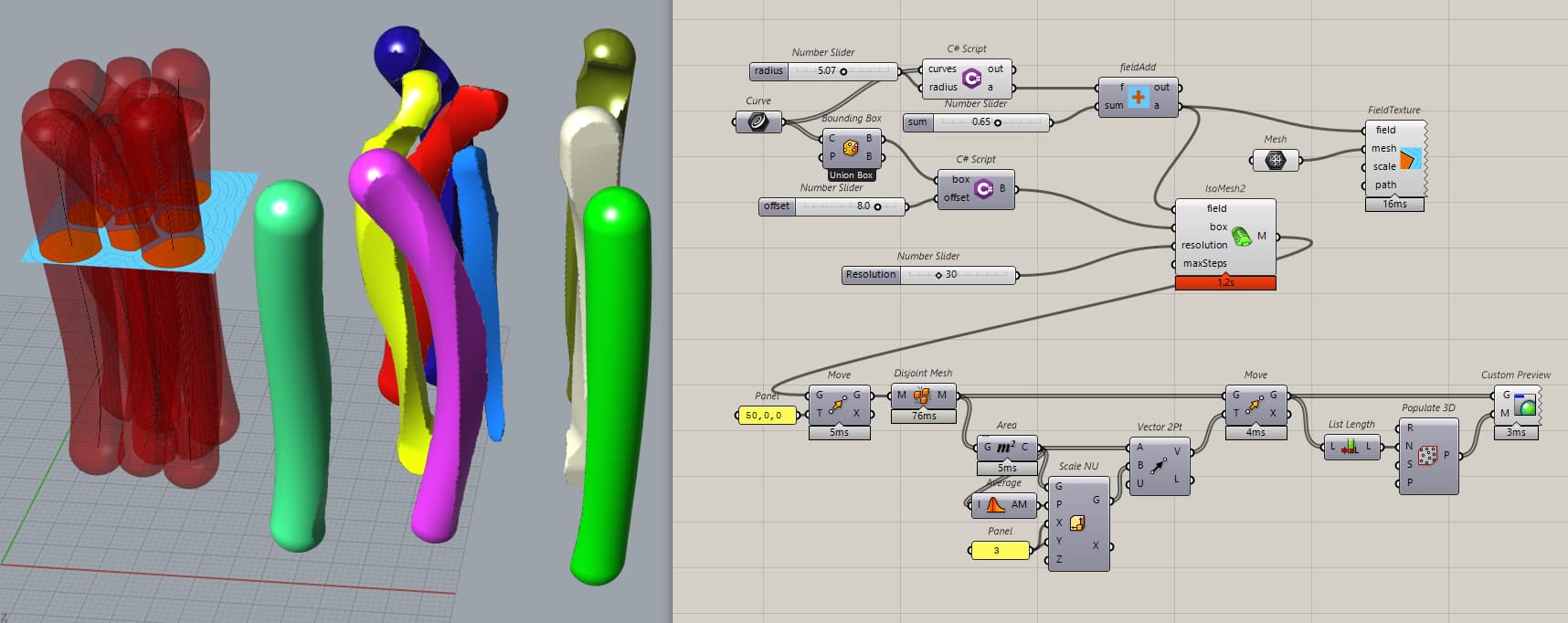

With SDF, Isopod, you can generate a field from a curve and subtract it with the fields of all other curves, the result is a shape that is voronoi-ish in each section (but the logic behind is not working on planar sections).
But you have to repeat this process for all elements, and it’s heavy, slow.
voronoi solid strips from curves.gh (17.0 KB)
We could indeed define Voronoi regions for curves implicitly, but I think there would be quicker ways of doing this than doing the difference with the union of all other items for each item in the list.
Ideally we would want to define a single field, something like the difference between the distance to the closest curve and the distance to the second closest. There are a few more subtleties than this, but the key idea is that the regions towards the interior of Voronoi regions have a clear unique closest object(which could be a point, curve, etc), while the the regions near the boundaries of Voronoi cells have multiple objects a similar distance away.

Curves/Pipes voronoi SDF!
voronoi solid strips from curves 2.gh (81.3 KB)
Heavy!
Should be trivial edit this to make it work with other kinds of geometries…
