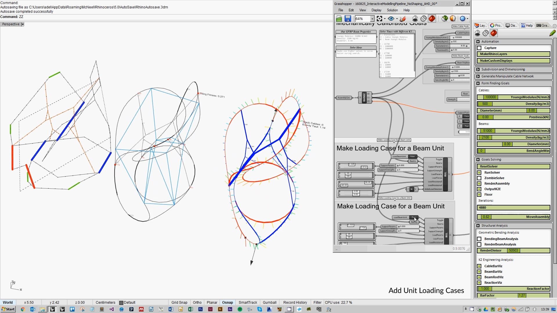

I’ve come along my way but I didn’t figured out yet how the linear constraint stops the rod from converging into a circle in your first little box example. I’ve been using constantTension and Length for that with trying out to use the intersection points as anchors..
<div class="post-metadata">
**Author:** ![AndersDeleuran](https://sea3.discourse-cdn.com/mcneel/user_avatar/discourse.mcneel.com/andersdeleuran/32/476683_2.png) [@AndersDeleuran](https://discourse.mcneel.com/u/AndersDeleuran)\
**Post date:** [December 11, 2025, 7:41am UTC](https://discourse.mcneel.com/t/bending-active-structure/189450/6 "2025-12-11T07:41:17Z")
</div>
I posted some of the source code back here, might help:
> [@Using kangaroo2 or Galapagos in GhPython](https://discourse.mcneel.com/t/using-kangaroo2-or-galapagos-in-ghpython/129932/19):
> No worries. I don’t think there is much documentation outside of the C# source code itself, which is pretty accessible through GHPython intellisense and the print() , type() , help() , dir() functions. Also, I just uploaded [some additional examples](https://github.com/AndersDeleuran/KangarooGHPython/tree/master/src) from our Smart Geometry 2016 and Advances in Architectural Geometry 2016 workshops. These were updated to work natively in Rhino 7 for a workshop at CITA in 2020 and are exported from this larger GHPython pipeline:
> [@Felix\_Berger](#):
> … how the linear constraint stops the rod from converging into a circle in your first little box example …
Maybe you can add a screenshot? It’s been a loooong time 👴
**Edit:** Here’s a super stripped down version of the Smart Geometry 2016 pipeline (i.e. just the shaping):
 ![2025-12-11 08_53_20-Greenshot](https://global.discourse-cdn.com/mcneel/uploads/default/original/4X/1/5/5/1555053a44bf6a4ce4a5646c028c0a2e6e16acb5.png)
[201210\_FAHS\_InteractiveModellingPipeline\_Minimal\_00.gh](https://discourse.mcneel.com/uploads/short-url/3j1VrEa61iltMF0MmiFftcEpGBz.gh) (45.7 KB)
The code here was updated in 2020 to run in Rhino 6/7. But haven’t tested with 8. Also it’s ten year old code so there are surely many things I’d do differently today. Notably regarding [drawing and dynamic/event-based stuff](https://discourse.mcneel.com/t/ghpython-content-from-aectech-barcelona-workshop/180533).
**Edit II:** Just tried running the definition in Rhino 8 and I’m getting a goal casting error. It does ring a bell, but afraid I can’t recall how to solve it. Thought it might be that I’m referencing the wrong Kangaroo2 assembly, but that doesn’t seem to be it. @DanielPiker might know why it broke?

> [@AndersDeleuran](#):
> … Thought it might be that I’m referencing the wrong Kangaroo2 assembly, but that doesn’t seem to be it. @DanielPiker might know why it broke?
Just tried using this non-explicit method to reference the `KangarooSolver` dll instead. I’m not really which assembly is being loaded now, but it appears to solve the IGoal error:
 ![2025-12-11 11_27_29-Greenshot](https://global.discourse-cdn.com/mcneel/uploads/default/original/4X/3/6/a/36ae0a90564f7017323017a6e9bdfc267a41ec02.png)
[201210\_FAHS\_InteractiveModellingPipeline\_Minimal\_Rhino8\_00.gh](https://discourse.mcneel.com/uploads/short-url/rMvqUsrqArBuWbQ2Xit5vwekfHX.gh) (47.5 KB)
Also, none of the downstream drawing works in Rhino 8. Likely because the custom display class is deprecated and there’s been a lot of updates to the drawing pipeline in general.

Yeah I’m not really sure what’s going on (ping @DanielPiker). From what I can tell the `clr.AddReferenceByName("KangarooSolver")` method gets the exact same assembly as using the by file and path reference method. Could be some .NET/core stuff that broke things maybe:
 ![2025-12-11 11_53_06-Grasshopper - K2VersionsRhino8_](https://global.discourse-cdn.com/mcneel/uploads/default/original/4X/3/7/1/371bc581b56567ef0ac05d913cfd1fc790fe6a3a.png)
[K2VersionsRhino8.gh](https://discourse.mcneel.com/uploads/short-url/311NmRr8JJ939QiMZ1IOWA0bZL3.gh) (5.1 KB)
But hey, if it works 🤷‍♂️
