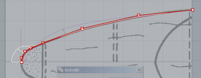

![rebuild screen](https://global.discourse-cdn.com/mcneel/uploads/default/original/3X/f/9/f9261dff4473ccc16472973dba18ddfceef1a8b8.jpg)
This is an overhead view of the nose of an aircraft fuselage. Probably the original plan was drawn using a parabola as a guide. In Rhino, I traced the curve using Interpolate curve, starting with several points pinned to the vertical line across the nose. The idea is to maintain tangency.
It took 34 points to draw the half-fuselage curve. I am now trying to rebuild it using maybe 8 to 12 points.
When I took level I, I must have looked out the window when the topic of rebuilding came up. Never quite sure how to proceed. The basic idea is to keep the shape of the 34-point curve while reducing the number of control points to a necessary minimum. But how, exactly?
The little barbell marker, for example. How am I supposed to use that?
Do we have a video on the subject of rebuilding?
Note that the rebuilt curve shown has lost all tangency at the fuselage centerline, so part of the problem is to restore it.
Thank you for your insights.
Michael

Hi Michael - I would draw this from scratch using the number of points you think you need and probably degree 5 using the `Curve` command. The key is not try to get it right the first time - remember you get to move points around - more in areas of high curvature, fewer in low curvature locations.
Something like this:
 ![image](https://global.discourse-cdn.com/mcneel/original/3X/c/7/c7a8c10b89eca90d263d53bd6808c18e48eb3c83.jpg)
Rebuild will not be able to space the points unevenly on its own - you’ll need to point edit.

Another approach would be to use you interpolated curve as input to FitCrv or RebuildCrvNonuniform. Try both commands, and experiment with the command parameters.
You may need to follow with editing the curve for tangency at the ends. You can use Match, or move control points. The direction of the end of a curve is determined by the control point at the end and the adjacent control points. The end of the curve will be tangent to a line connecting the two control points.
The “barbell marker” shows the location of the maximum deviation between the original and rebuilt curves.

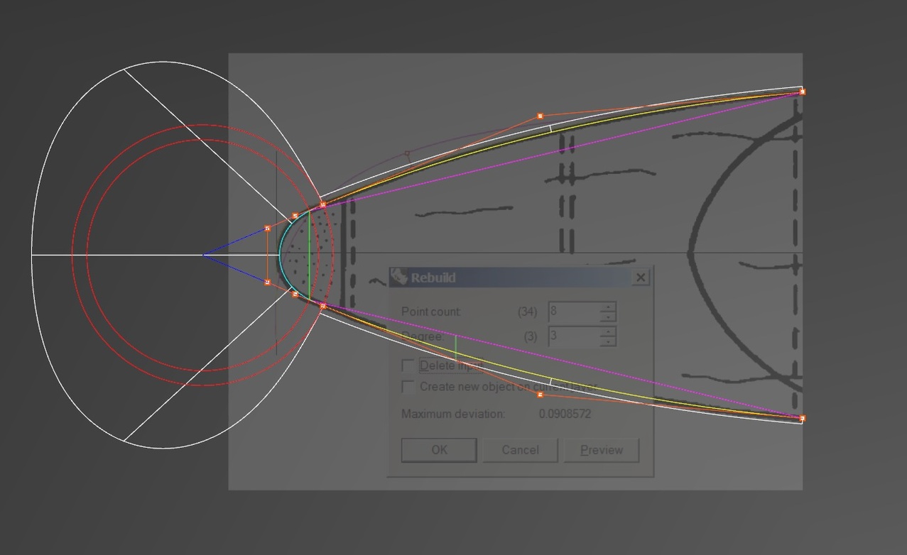

I would do it differently,
don’t be afraid to split curves into more segments. I always look out for parts with low curvature, which are base shapes. You start with a line from the start and endpoint of this part. Now you increase degree or rebuilt your curve to 3 cps and degree 2. Moving the middle part up to maximum of the curvature, adjusting all three points. Bezier curves of order 3 are always smooth. If this does not sufficiently represent a shape increase degree again to a Bezier curve with order 4 (CP 4 - Degree 3) and so on. If you can’t represent with an Bezier of order 6, your reference is not smooth. In that case I would diverge from the reference in order to stay smooth.
After finishing base parts, you blend or fillet the strong curved parts. Good blends, are if the intersection of the theoretical shapes are in the middle of the blend. So a trick to get good blends is to draw a circle at the intersection point and trim theoretical curves in order to get that criteria fulfilled.

![rebui](https://global.discourse-cdn.com/mcneel/uploads/default/original/3X/e/4/e4e3d13f909aecb454a71e069a5cb2880ed48c9d.jpg)

TomTom brings up a good point. Look at the shape and any other information available and think about how the original was designed and built. For example the nose radome may be spherical which means that the section of it is circular. A circle with the 3Point option resulted in a "perfect fit to it. Use a portion of the circle as an arc for the radome. Then develop the curve which goes from the circular arc to the fuselage side. The continuity from the radome to the side of the nose may be only tangential.
Also be aware that drawings such as you are using are frequently not exact. This can be for several reasons - the original was intended for illustration, not engineering; distortions during the reproduction processes; or distortion deliberately introduced to conceal the details of the design and inhibit “reverse engineering”.

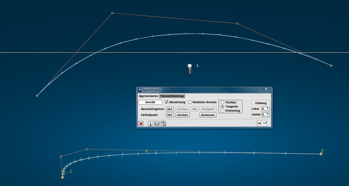

**Rhino just needs a good (re-)approximation algorithm with integrated smoothing.**
@pascal @davidcockey
That would improve Rhino shape quality much more. You can use such algorithm in addition to any other shape functionality such as offset, surface matching/blending etc. It is something manageable but would have a great impact on the whole software. In comparison to other design cad software most professionals I know, argue that Rhino simply creates too much cps, which is why people need to use software like Alias or Surf in order to create shape quality in a certain timeframe. Even if their task do not involve much complexity. Its just you need to reduce cps after everything you do, otherwise you end up in a horrible shape. For instance, matching a surface to a matched surface returns a nightmare. Now what if your matched surface is always reduced as much as possible after the process of matching…
I was actually requesting that 2 years ago, McNeels answer to this was you need to interpolate or rebuild not approximate…

Although I don’t like to compare Surf with Rhino, it just shows what I mean by approximation, here are your curves reapproximated to the same parameters as chosen by you. As a proof that there is a functionality doable.
