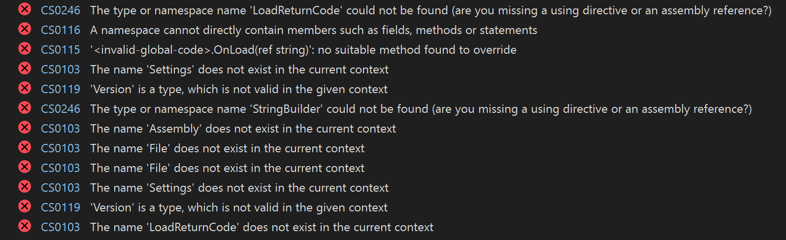

**Author:** ![CassieConti](https://sea3.discourse-cdn.com/mcneel/user_avatar/discourse.mcneel.com/cassieconti/32/380348_2.png) [@CassieConti](https://discourse.mcneel.com/u/CassieConti)\
**Post date:** [May 23, 2022, 7:36am UTC](https://discourse.mcneel.com/t/basic-c-plugin-help/142761/7 "2022-05-23T07:36:32Z")
</div>
![image](https://global.discourse-cdn.com/mcneel/uploads/default/original/4X/3/4/2/342b2e348b2dd7cd1cbddce40aaac696df075875.png)
there’s a lot of red-underlined code …that cant be good

try moving that code above this closing brace

no change
 ![image](https://global.discourse-cdn.com/mcneel/uploads/default/original/4X/5/2/7/5279b5bff97c290faabb1ee42a88bf1365e529bd.png)
 ![image](https://global.discourse-cdn.com/mcneel/uploads/default/original/4X/8/f/c/8fceaacd8f2b4bc3bd341ac70acaade21b4f5809.png)
Am I missing something?

Go to the top of the file and add a `using System.Text;` similar to the other `using` statements you will find there. After you do this, you should see the squiggles disappear from the line that creates a `new StringBuilder()`.
This is because the StringBuilder class resides in the System.Text namespace, and you have to tell the compiler where to find it, either by adding a `using` statement, or (and you can try this before adding the `using` statement) by fully-qualifying the name, by writing `new System.Text.StringBuilder()`.
After you try that, then note that you can hover your mouse over one of those errors with squiggles, and be shown a popup that contains some possible suggestions for how to fix them, and in most cases here, it looks like it will suggest to do similar to what I described above for System.Text.StringBuilder.

Thanks so much for your help,
Turnes out it wasn’t so basic, at least not for me.
By following @jdhill suggestions I’m down to 7 errors from 12.
Most were missing namespaces

the remaining are
_On Load_
_Settings_
_Version_
_Assembly_
What are these?
missing classes?
 ![image](https://global.discourse-cdn.com/mcneel/uploads/default/original/4X/3/9/6/396142cc8acecccacb622fd7ca781a22922c7efc.png)

No trouble with installing rhinocommon Rh7 extension, just went to menu\> Extensions\> extension manager.
Turnes out your first suggestion on fixing the indentation was spot on. I just had to move two braces inward not just one. 🤦🏽
