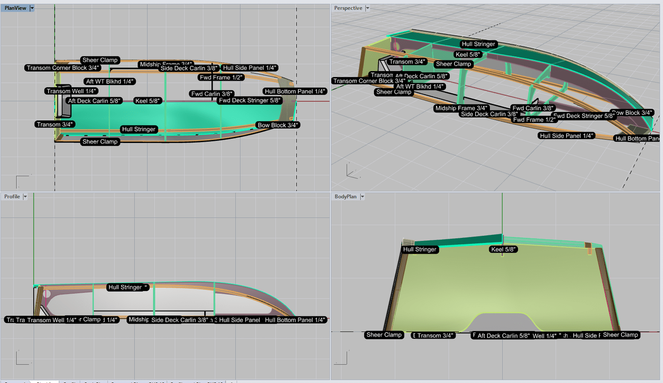

Is there any way to change the orientation of the axes such that the X axis increases in value from right to left rather than left to right?
Ships are drawn with the bow at the right and stern at the left.

Jim,
That is something that really bugged me when I switched from MaxSurf to Rhino for all my Marine Design 3d modelling. I tried renaming the windows and rotating the axis as you mention but in the end it was just easier to draw my boats and ships with the keep oriented to the x axis and the beam becomes the y axis. The bow view ends up as the Rhino RIght window and the profile becomes the Rhino Front but you will soon get used to that. By far the easiest thing to do.
 ![image](https://global.discourse-cdn.com/mcneel/original/3X/3/d/3dd7ce524a4ee1c335e0348dd8c3dc3496487fda.jpeg)

Jim, I mean’t show the 4 view earlier and how the profile is the front view by default and the body plan is the Right view window in Rhino. The orientation is by NA standards other than that.
 ![image](https://global.discourse-cdn.com/mcneel/uploads/default/original/3X/d/d/ddcc56fdfc7157958b80c70040b1da4ea7180238.png)
Orca3D has an alternative 4 view labeling by NA standards but for some reason you have to go into their prefs and tell it to make the x axis is the positive direction. It defaults to neg X for some reason.
 ![image](https://global.discourse-cdn.com/mcneel/uploads/default/original/3X/c/3/c3356f8555029c7ad51553753a791a4c0822578d.png)
Not worth messing with, just put your hull origin at world zero and the loa along the x axis and don’t sweat the front/right issue.
