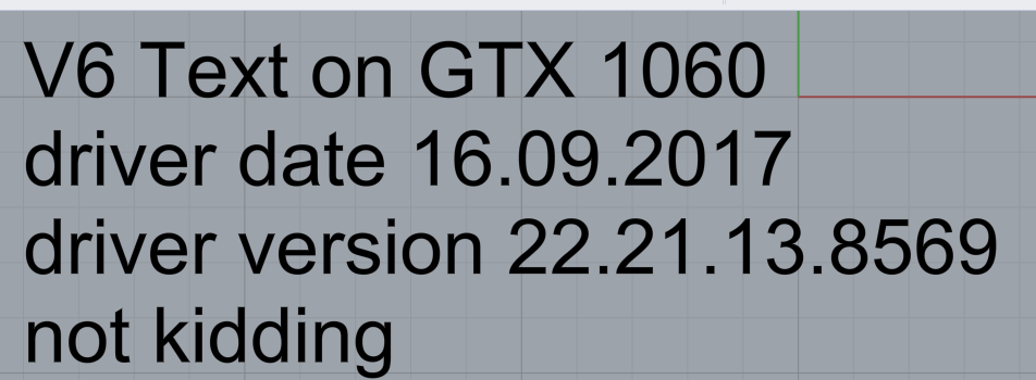

Rhino V6 text looks aweful ; at least here on my computer.
And with GPU tessellation turned of in OpenGL settings under Rhino options?
GPU tessellation has nothing to do with this effect. We use a shader for text drawing that has issues with some drivers. TestGlyphy command in Rhino will change the shader used to a texture based one which will look correct, but has it’s own set of problems.

This is a GPU driver bug. It may be fixed if you can update your driver. We realize this is a bug and are trying to figure out what to do about it.

I don’t see this on my GTX 1060
I noticed a newer driver (package 388.31 from November 15th) is available, so downloading that to see if that makes any difference (currently installed 385.69)

Anyway, with latest (vanilla) drivers from nvidia.com
What does the gtx properties dialog through the device manager tell you the latest driver is?
Using GTX1050… seems ok.
