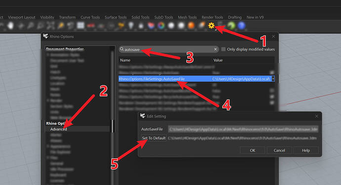

Could you please try to repair RhinoWIP ? Thank you.
That doesn’t appear to have actually changed it? The Templates are also pointing to 7.0.
Please try clicking Set To Default at the following location to reset the default settings.
Yeah that did it…
