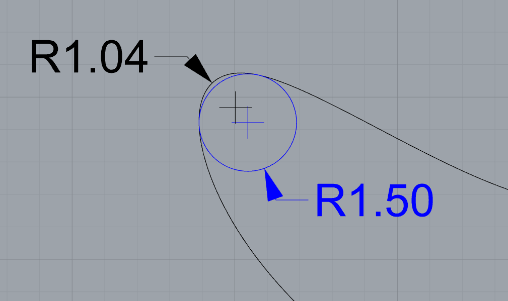

Is there any way Rhino6 can automatically detect the minimum radius for a curve and correct it to fit a tolerance? See illustration below. This would be a huge time saver for drawing things that have to be machined with a cutter that has a limited minimum diameter. I can compensate for this when I generate a toolpath in CAM but I am looking for a way to do this to the drawing.
Hello - The Curvature command will help locate and mark minimums but you’ll need to fix it yourself…
Thanks Pascal! Here’s how I do it now using curvature graphing. I offset a pair of lines to match the curvature graph of the diameter cutter I need to use and visually inspect for anything that sticks out. But It’s still a manual correction process which gets pretty tedious on complicated designs.CAM will take care of it but I can’t see the actual finished design until after simulation and the visual image is no longer an editable nurbs curve.

Another method which replaces portions of the original curve which which the cutter cannot reach with fillets:
  1. Offset with cutter radius to create a cutter centerline curve. This curve will have sharp corners in areas which the cutter cannot reach.
  2. Offset with cutter radius and Corner=Round to create a new curve. This curve will have fillets corresponding to the sharp corners of the cutter centerline.
  3. Explode the new curve and delete portions of the new curve which are not fillets.
  4. Use the fillets to trim the original curve, and join the remaining portions of the original curve and the fillets.
Example based on Pascal’s curve: MinRadiusDC.3dm (32.5 KB) (Corrected file attached. Previous version had spurious text.)

Thanks @pascal ! This is an interesting solution that maintains the extent of the the original curve without shortening it’s reach into the corner. As you say though it still requires manual editing.
Thanks @davidcockey! I like this approach very much. If it were not for the increased control point density of the offset curve I could simply accept it without trimming out the corners on the original. And sometimes if I’m really done editing I probably will do just that.
But often I will want to retain the ability to edit CPs between the corners and so the final step replacing the corners on the original curve will be desired. I’ve written a small Grasshopper def to automate visualizing this but can’t seem to figure out how to get the fillets in the corners to trim and replace the original curve automatically. Hope someone with better GH skills can have a look.GH%20minimum%20%20radiusminimum radius curve.gh (4.0 KB)
