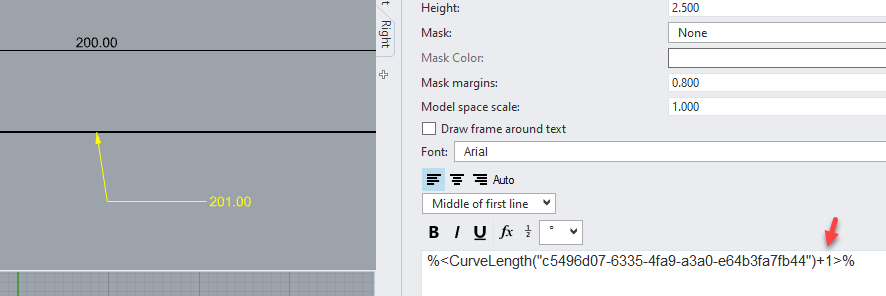

I’m looking a way ti set the quote automatic show the right linear Numbers increased by 1 unit; so for exemple, a segment of 200mm at the end of a quote command have the value showwd in the draw of 201mm…

Hello - what is this? Is this a text field, maybe? Can you provide an example?
Maybe this:
%<CurveLength(“6881abc5-3a79-4a0c-b997-c9d2f2c79a71”) +1>%

xthe way is in the direction you are looking for but I need an expression that provide automatical increment of 1 unit of the original quote for every segment I’ll quote
Hello - something like this in Python may do:

Does that help?
Thanks Pascal!
