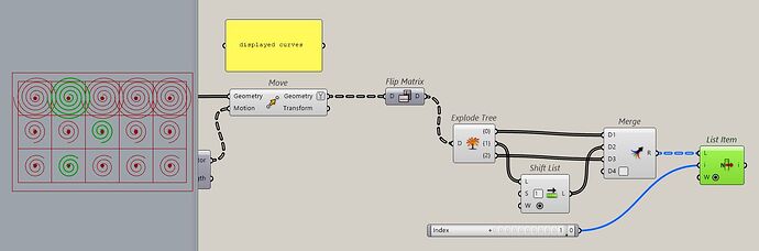

To select only three curves.
and is there anyway so i can select them like only odd numbers??
Do you mean like this?
yes but i would need it to be automatic, because sometimes i would need to position 3 curves, maybe other time 5… and that way i need to be changing explode tree component to match outputs
Basically you would like to select odd or even numbers.
