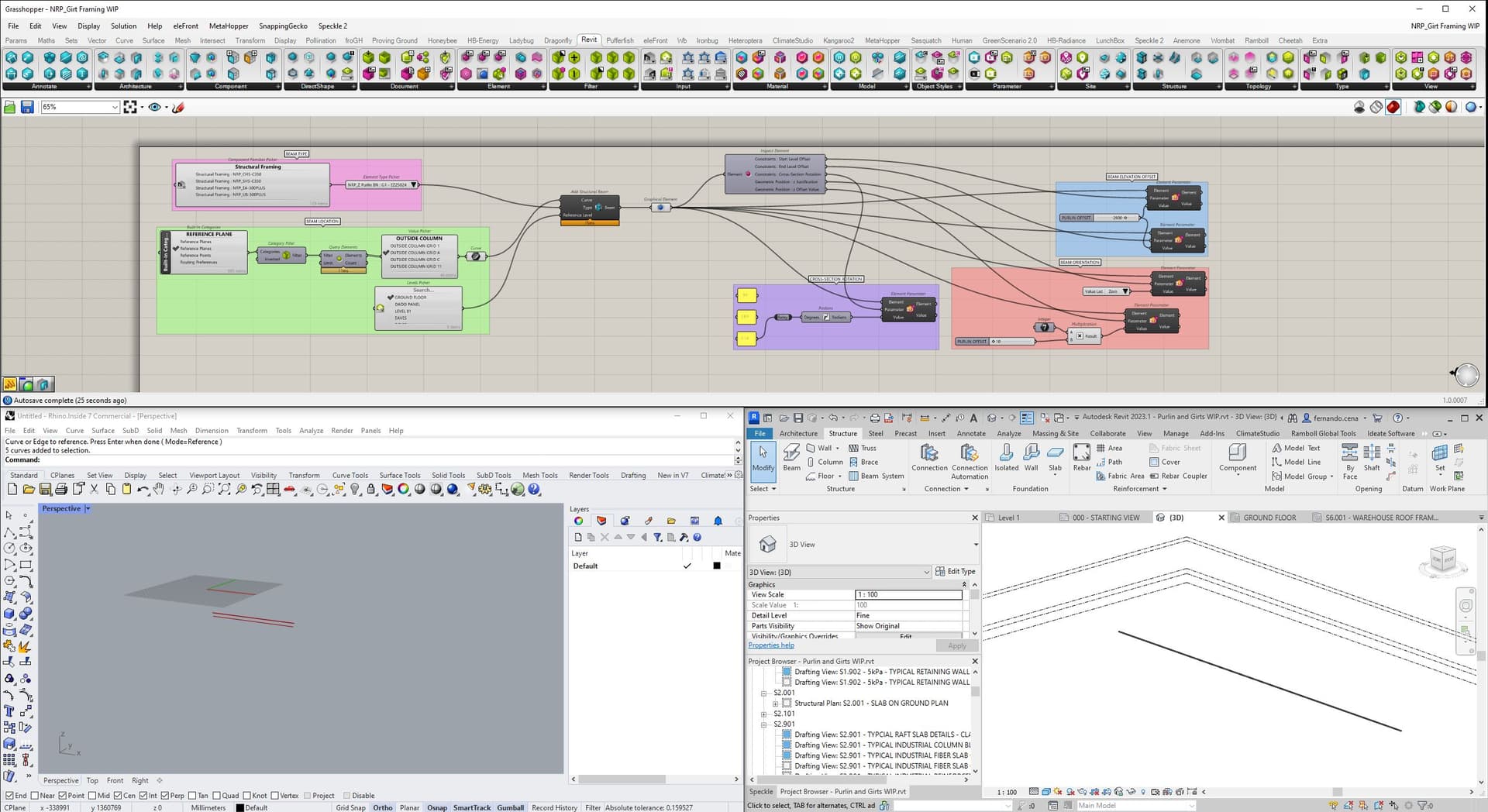

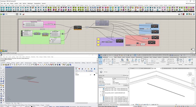

I’ve managed to get a start on what I want, which is to model a base girt around the perimeter in the right orientation. However, I can’t work out how to place a top girt and then space them equally with a maximum limit of centres. What am I doing wrong? I’ve tried to array the curve and the beam and can’t seem to get it to work.
NRP_Girt Framing WIP.gh (16.4 KB)
Purlin and Girts WIP.rvt (18.1 MB)

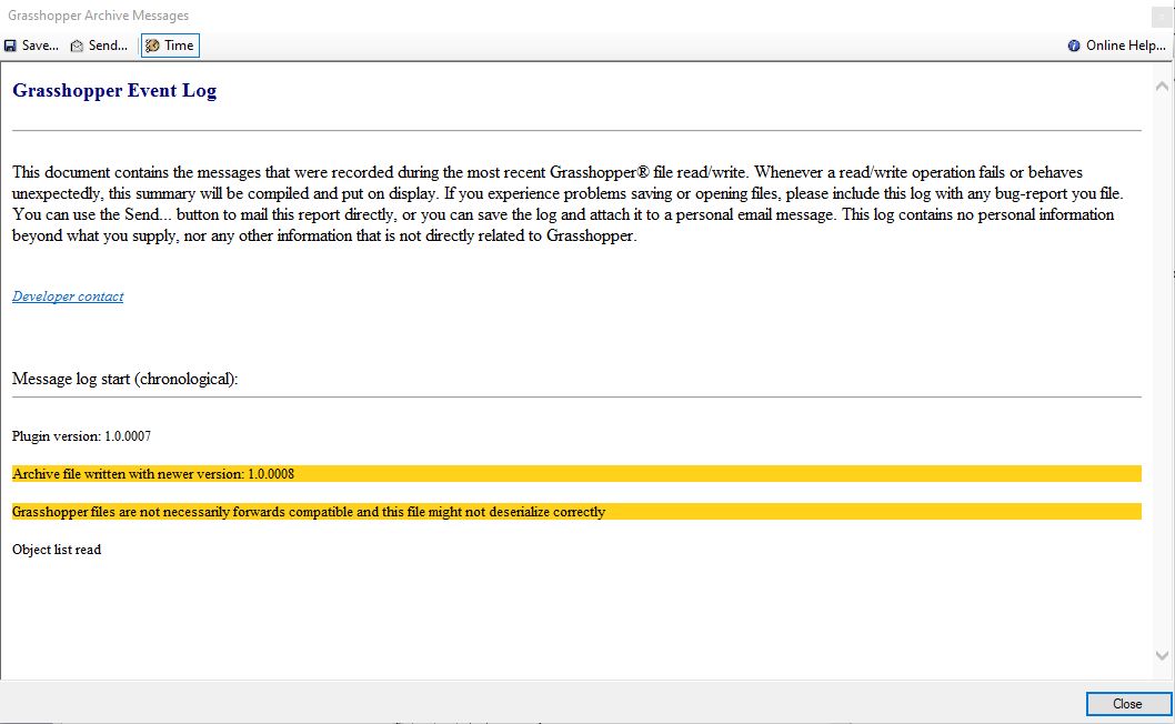

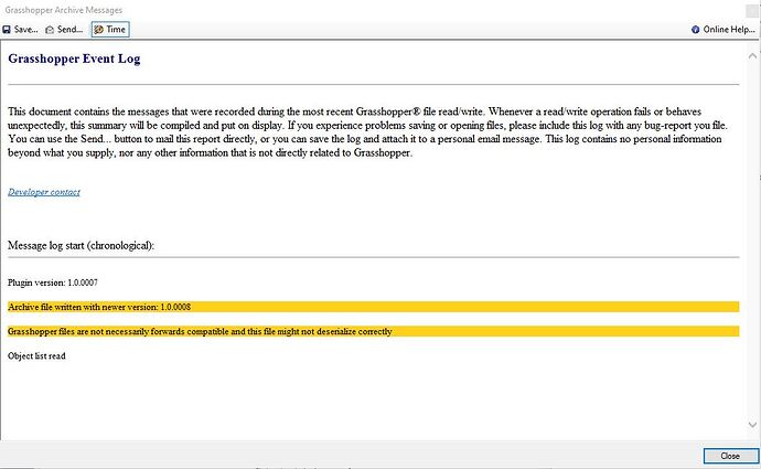

I am able to open your file in Rhino.Inside.Revit but I am getting the following warning:
I can see that you are placing a beam and that you are modifying its parameters later, but I cannot see anything related to the spacing of the girts in Grasshopper. Could this be related to the first warning? Am I missing some components?
Regarding your question about placing and spacing the top girts, I think it is just a matter of finding the logic to create the curves to draw the beams in Grasshopper, like you would do manually in Revit. However, in the file you sent, I am not sure which view or elements I need to look at to create the spacing of the beams/girts. Could you be more specific with this? :sweat_smile:
