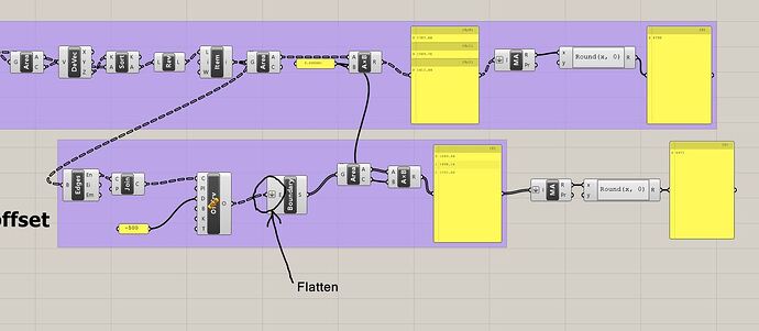

Hi. I spent some time trying to make a script that calculates areal of Breps that has holes, but not sure what I made is the right way.
I would like to calculate top surface area of the volume(Gross floor area), and 500mm offset to inside from the boundary of the surface(Net floor area with 500mm wall thickness).
And finally, Gross floor area and Net floor area of the all floors.

It works! But I was hoping to use the part that you added to the other areal script which I think is slightly better, and it does not seems to work the same way. It might be the sort of same question, but hope it is okay to repeat.
Is it possible to use this script and offset 500mm toward inside from the outer boundary and calculate the area?(Still have a problem subtracting the area of the hole) BTA BRA test 20220324.3dm (11.4 MB) bra bta 20220324.gh (23.8 KB)
Is it possible to use this areal script and offset 500mm toward inside from the outer boundary and calculate the area again? (A problem with subtracting the area of the hole)

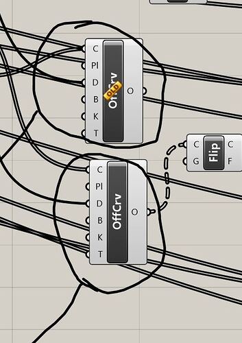

Some of the boxes offset toward outside, and some of them offset toward inside.
How could you “flip” the direction of polysurface or closed extrusion?
Hello, Iam also trying to calculate the area of Brep with hole. As mentioned in your script we can put an offset curve to cut out the hole. It works for me too. Thanks for giving us a solution. But It seems to be a manual job.
It would be great if a script can automatically identify the hole in brep and cut it out from toal brep area.
