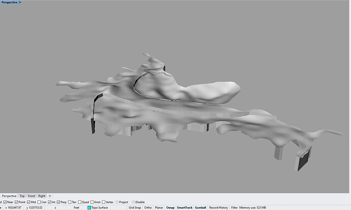

I’m trying to view one of my projects in arctic view but it’s not coming out how it would normally produce an arctic view. This isn’t the first time it happened to me, last time the problem fixed itself but it has not yet.
If the command _ClearAllMeshes doesn’t work you may have to move your object closer to world origin. According the status bar info in your screenshot it is quite far away.
I moved it closer to the world origin and I tried the command, it still looks the same.

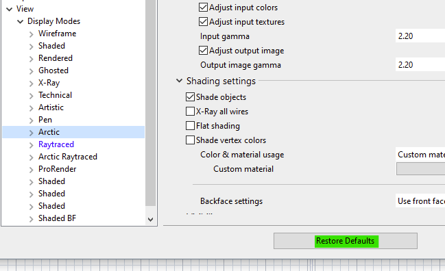

Also maybe reset the Arctic mode settings, in case you’ve changed it all unwittingly. Tools > Options > View > Display Modes > Arctic || Restore Defaults
Ok, I tried it but it still looks the same.
