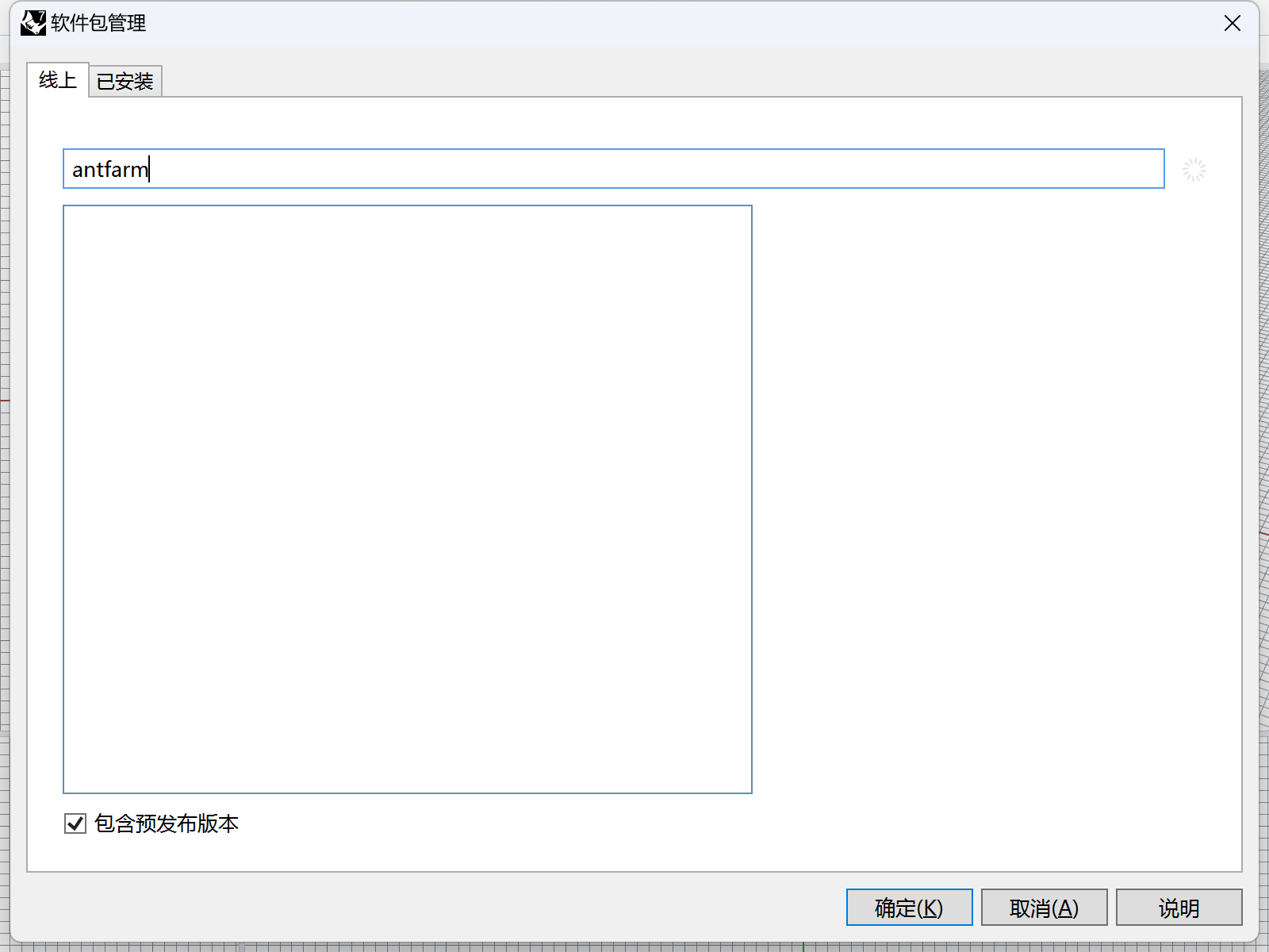

hello,this plug-ins is great,but i could not install antfarm.this pictu
1
re is the issue i get
Hi -
Please run the Rhino ‘SystemInfo’ command and copy-paste the result here.
Rhino 7 SR1 2020-10-25 (Rhino 7, 7.1.20299.23101, Git hash:master @ 8d9ce31398d29589acec390d2167dc68806d5b79)

The current version of Rhino 7 is SR32. I guess that AntFarm requires a more recent version than what you are running.

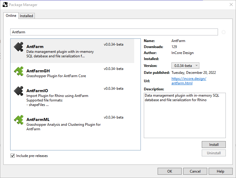

sorry,i don’t understand.may be your answer is i could find it in package management, but it can’t run?.just like, i might take early version.oh, it’s importtant ,i could find it in V7.0, but it dodn’t work.now,whatever version i download, i just could not find it in package management(ps. v7.25/v7.29/v7.5/v7.9).
ps.the issue i take just like pic2
