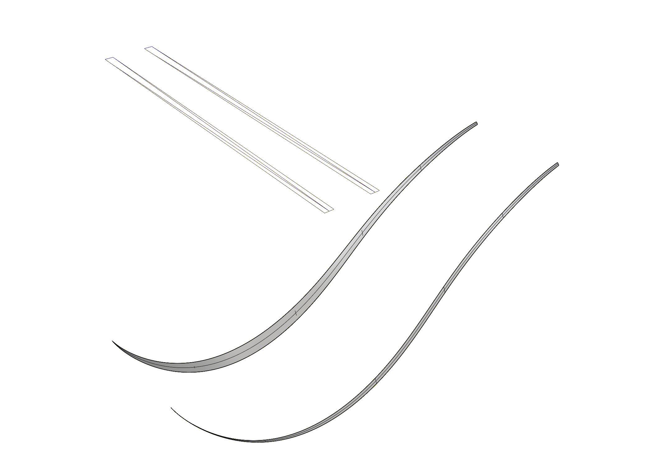

On the left, we have a trimmed surface. When I make a very slight movement to its control points, this trimmed surface changes dramatically, ending up like the shape on the right. Why does this happen?
I checked the properties of this trimmed surface and found that it has a degenerate region and also an edge tolerance. But I still can’t quite figure out why such a minor adjustment leads to such a massive change. I’ve run into this situation several times before and have never fully understood the root cause. I’d really appreciate it if you could take a look and share your insights. Thanks a lot!
I’ve been thinking about this for a long time today, trying to understand what’s actually happening at a fundamental level, but I still haven’t figured it out

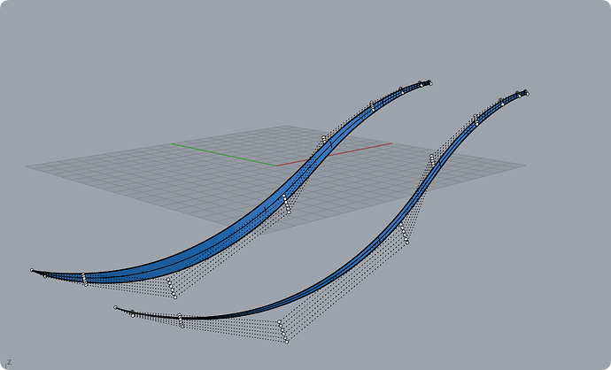

_untrimAll will show the edit you did to the surface
edge Tolerance
this is the correct explanation:
_what will show a edge tolerance of
  Edge Tolerances: 0.000 to 2.623
on a nice surface it should be within document tolerance. 0..0.001
so your initial surface has bad trimming.
now moving the cv s will force rhino to recalculate the trimming and end up with the result you see.

you have more a less a quite unusual setup for the marked (x) corner:
the edge is nearly collapsed (length 0.001)
and the corner is Angle = 179.320 Degree - close to 180.
so it s more a degenerated corner and an micro edge that is not fully collapsed.
and yes there is a good chance that this caused the bad trimming… but it s impossible to guess how it was done.
showing an edge with about 0.001 mm length (the 6 cvs)
if this is the geometry you need - depending on the next steps you need the surface for:
(A) draw a proper collapsed edge - > _SetPt all 6 CVs to one Position.
or
(B) better in most cases: draw a proper 4 sided Surface with corners as close to 90 degree as possible. 30 to 150 Degree for the corner should be possible without problems, maybe even 5 to 175 is fine… for the trimming of this surface - i always try do do not have trimmed corners below 1 or above 179 degree.
