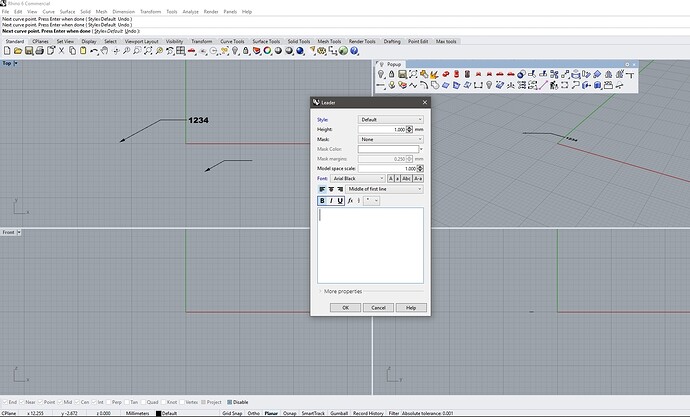

i have set up and not changed the dimension and leader text in a few annotation types , all is ariel however , when i make a leader , it is ariel black and that should not be as the setup is ariel there is a Bold B behind the ariel in the setup screen (can not do anything with that but it is there)
so i want to have ariel or any (as dialed in in the annotation set up ) and not ariel black that comes back every time

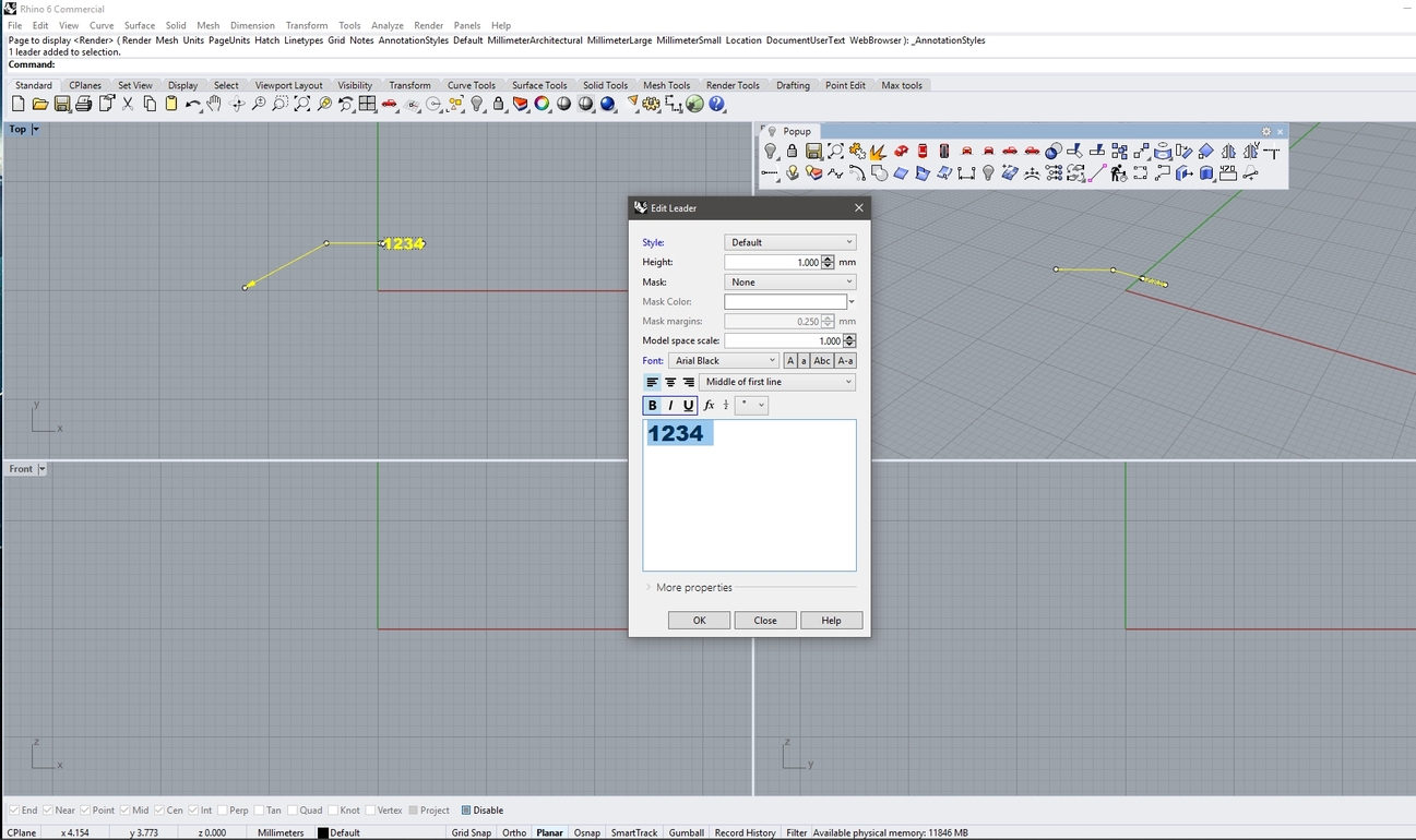

it is not the file it is rhino examples enclosed font1 shows the propertie screen as it is , see the choosen font ariel! font3 when you make a leader , th efont is changed to ariel black and in two when editing
Hi Rob, this is a recent bug that that occurs for certain operating system languages and has been fixed. The fix will be available as soon as the next 6.17 RC goes out. See RH-53897.
