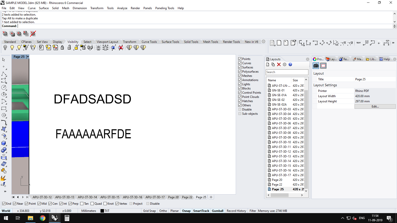

I am using rhino 6 version(version 6.17.19235.15041, 23-08-2019) I am having Two problem of annotation style overrides
  1. when i copy text from on text box to another text box new text will show override annotation style.
    it should copy text only not with annotation style for text right ?
  2. Override text doesn’t modify when clicked remove overrides in properties tabs. (image no 4)
