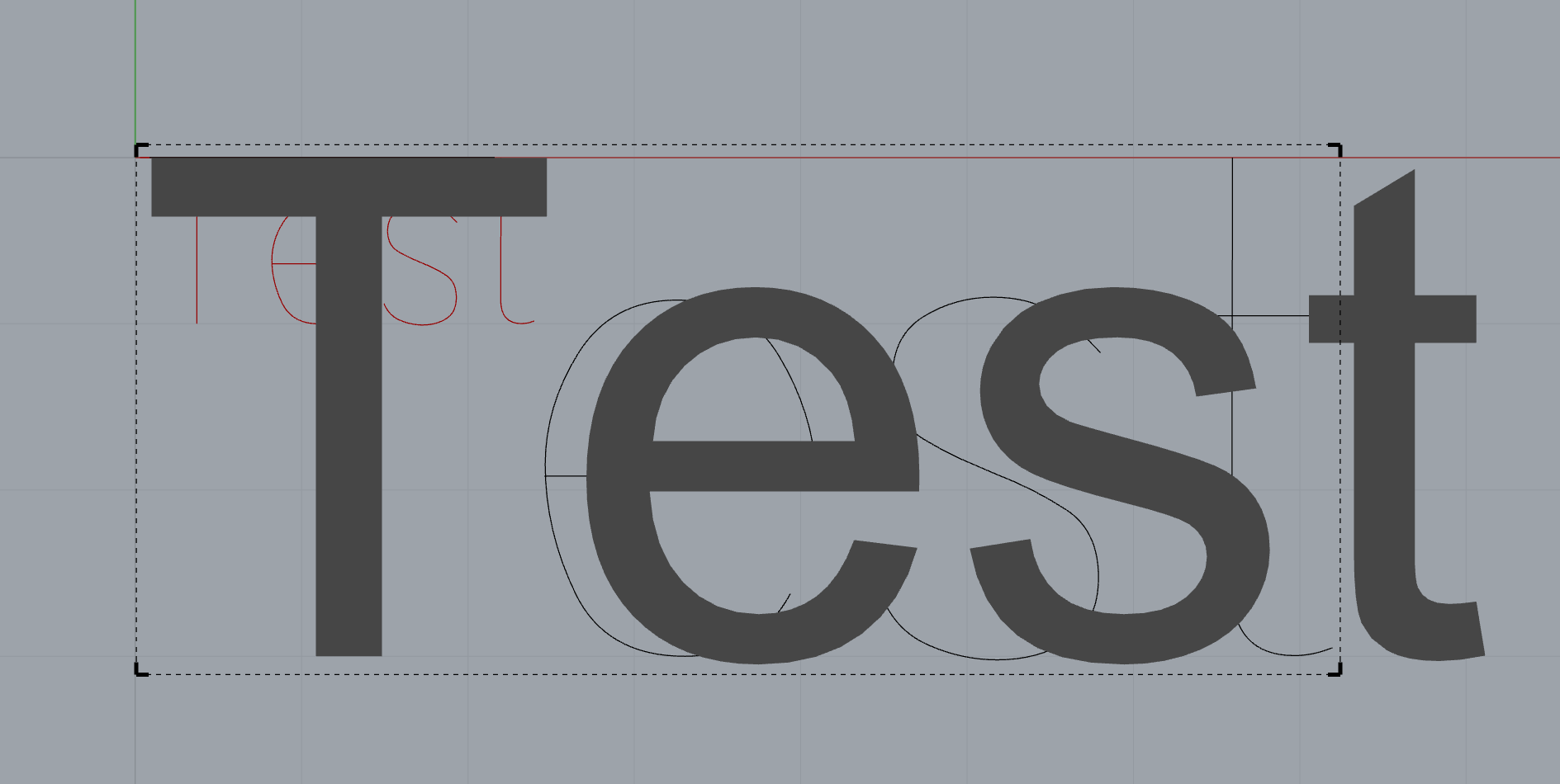

The definition works in Rhino 8 but in Rhino 9 always bakes with Arial font. I’m confused.
[text\_entity\_annotation\_style\_8-9\_issue.gh](https://discourse.mcneel.com/uploads/short-url/csxU3nPLvye8bXBCBowX8OkJplQ.gh) (5.9 KB)
 ![image](https://global.discourse-cdn.com/mcneel/uploads/default/original/4X/b/b/d/bbdc93f227290a1f68215abdd1d0899c6da1d7a9.png)
 ![image](https://global.discourse-cdn.com/mcneel/uploads/default/original/4X/0/e/b/0eb23501e682f558c249ea1a8f4117361d8ea9a3.png)

Rhino 9 WIP fails to cache the text with the correct font:
 ![image](https://global.discourse-cdn.com/mcneel/uploads/default/original/4X/c/d/d/cdde28da40fc8eb5819c5b58fb45799afb9ef664.png)
 ![image](https://global.discourse-cdn.com/mcneel/uploads/default/original/4X/1/9/f/19f93623bc5146999ade7890f30be5e688f56cfb.png)
It is fairly confusing:
 ![image](https://global.discourse-cdn.com/mcneel/uploads/default/original/4X/8/5/f/85fb61352a5c7f52e8eef8b2ee93a572c62246a8.png)
Grasshopper shows SLF-RHN font but Rhino displays with Arial
I opened your file in Rhino 8 and it works as expected.
 ![image](https://global.discourse-cdn.com/mcneel/uploads/default/original/4X/b/8/0/b803306612da276c9902d7aab23c77e9253909d7.png)
 ![image](https://global.discourse-cdn.com/mcneel/uploads/default/original/4X/1/b/c/1bcd75c842266f25a7baa5949dd0edc1389d7071.png)

Here is what i am seeing:
![scaletext](https://global.discourse-cdn.com/mcneel/uploads/default/original/4X/f/b/6/fb6dfeacca408410664e0b10331ecc306ed2d8c2.gif)
<div class="post-metadata">
**Author:** ![martinsiegrist](https://sea3.discourse-cdn.com/mcneel/user_avatar/discourse.mcneel.com/martinsiegrist/32/498369_2.png) [@martinsiegrist](https://discourse.mcneel.com/u/martinsiegrist)\
**Post date:** [December 1, 2025, 9:33pm UTC](https://discourse.mcneel.com/t/annotation-style-issue-again/213045/8 "2025-12-01T21:33:24Z")
</div>
> [@scottd](#):
> So, in the example I sent the font is correct
On my end the font of the text in Rhino is not correct. In Grasshopper it shows the correct font.
The size is not a problem.
 ![image](https://global.discourse-cdn.com/mcneel/uploads/default/original/4X/2/3/8/2382d4774f79a7526ebe4acfbc4a158b5f7df236.png)

I tried this on my laptop where I have 9.0.25329.12305 installed and the result is the same. The previous installation 9.0.25324.06305 shows the same issue. The cached text entity and leader is using Arial instead of SLF-RHN Architect.

Hi Martin,
I see this too, in R9 GH is always baking with Arial, regardless of the Annotation Style settings, even though the Preview shows correct font:

We are looking into it. Hopefully, we can get it fixed.

[RH-90813](https://mcneel.myjetbrains.com/youtrack/issue/RH-90813) is fixed in Rhino [WIP](https://discourse.mcneel.com/t/welcome-to-serengeti/9612)
