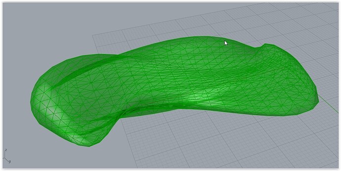

I need to adjust the points of the structure in the figure so that the edges are not higher than 45 ° with respect to the XY plane. It doesn’t matter if the structure changes geometry considerably, but for molding reasons I have this need. In recent days I have received some answers on this, but I would like to know with which function it is possible to do a similar operation.

Well … you are using Voronoi (I hate that thing) for your graph. That’s 100% Academic and totally unsuitable for any kind of rational engineering (even for artistic purposes), See a proximity take on that matter. You can get your prox pts collection using a Brep or Mesh as container as well resulting a far more interesting - i.e. not something out of an ugly box - graph (notify if you need a C# demo) and a distorted 3d grid that “looks” like random points in 3d space - meaning 100++ times faster results.

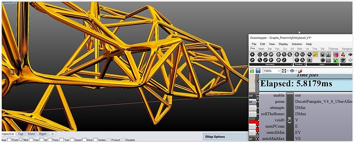

As I said the proximity way (briefly outlined in V1C) could use a container (general case) and random points inside. Then it computes the connections with respect min/max distances and the max connections allowed.
Illustrated the procedure has as follows (in action a C# that works differently than the native prox component - since, in my case, that kind of stuff is solely used for random trusses and the likes - I’m in the AEC market sector).:
Note: The “shape” of the graph is more or less dictated by the container and the density of the points. There’s various ways to control the creation of the naked edges but none of them is suitable for a novice not familiar with code. The last pics are TSpline tubes (questionable quality results [twists], mind).
Note: As you can see the big thing with proximity is the island detection … and in 99.99% of cases the structural integrity of the graph (if you want to use it as a truss). But with regard the structural part the Voronoi approach is way worse (and it takes ages to finish and it may yield tiny segments and …).
Note: The V1C does a prox graph using a box.
Anyway If you want that C# notify (but if you are not familiar with code … there’s not much that can teach you).

Well … get this … but is 100% C# AND is restricted (all things that have some meaning in real-life AEC matters are removed [islands and some other stuff]). Works with any valid GeometryBase input that is either a closed Mesh or a solid Brep.
Graphs_ProximityEntryLevel_Public_V1.gh (158.3 KB)
Unless you have plans to learn how to code is not that usefull for you (but in the V1C provided above there’s native components around).
The important part is the way that you access the vertices/edges and their neighbors (vertices or edges): The thing provides a List of vertices (V) and edges (E) and the 3 common connectivity DataTrees that we are using in Graphs (in fact in real-life V and E are one dimension paths Trees and the conn Trees have 2 dimension paths - where the first is the island index). So it differs from the prox component. Plus it measures the min (of mins) and max (of mins) distances and restricts the search (auto mode) within that Domain of values. Is written having solely real-life big AEC trusses in mind (where triangulation [and stiffness] is king).
