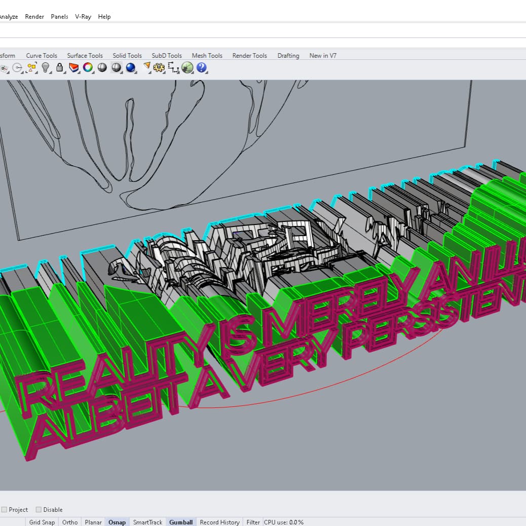

A client asked me to create an anamorphic sculpture from the text “reality is merely an illusion.” The challenge: when light passed through the piece at the right angle, the shadow should reveal Einstein’s face.
Using Rhino + Grasshopper, I built the parametric model, ran projection simulations, and prepared everything for 3D printing. The outcome: a sculpture where text becomes portrait, proving how design and computation can turn ideas into working solutions.

Did you simulate the shadow in Grasshopper while creating this design, or did you do it manually?
For something like this, you don’t need to simulate the shadow while working. Because the image comes directly from the light source and the source is more or less a point, you can raytrace the edges of the image to the source and then subtract that from the model. That’s kind of what that pyramid form in the second image is, if that helps to visualize it.

So you get the intersection between the point projection and the object and this forms a contour that you remove from the part? Or do you remove like a pipe section from it?
Not quite either. You take the object you want to create a silhouette of and place it in the scene, take the point your light is coming from, and extrude the curves to the point. Close them, then subtract from your casting object. The script for this is really simple in Grasshopper - whipped this up in about 30 minutes.
Piano with silhouette curves.
Grasshopper script to subtract light frustrum.
Raytracing render without curves. I cranked up the intensity of the point light and removed skylighting to make the effect more dramatic. Spotlights and other directional lights will need different techniques, but the concept is similar between all of them.
