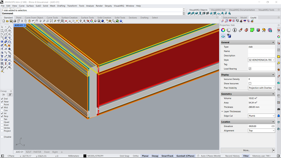

@fsalla @enric I would like to ask you if is there any possibility to add another entity or functionality. Take a look at these pictures:
I know this could be much simplier but I want the way it is :wink: So, let’s say there is a kind of ā€œenvelopeā€ working partially as a wall, partially as a slab. I want it to have the same layers and, as you can see, slabs could enclose the space on the top and bottom surface. To get this effect I have had to prepare 11 different entities, walls and slabs… It could be much more convenient if there was an option to flip slabs, as we can do with walls. Then I would need only 6 entities :wink: It could be even more easier if walls could interact with slabs: all the definitions have the same layers, with the same setting (normal/core etc). Then 1 entity would be enough. Well, what do you think? I could send you a bit of this model for analyzing.
Oh, I haven’t added ā€œsideā€ walls, I just don’t need them. But I have tried just to check how these would work. This is a real pain to get good connections..

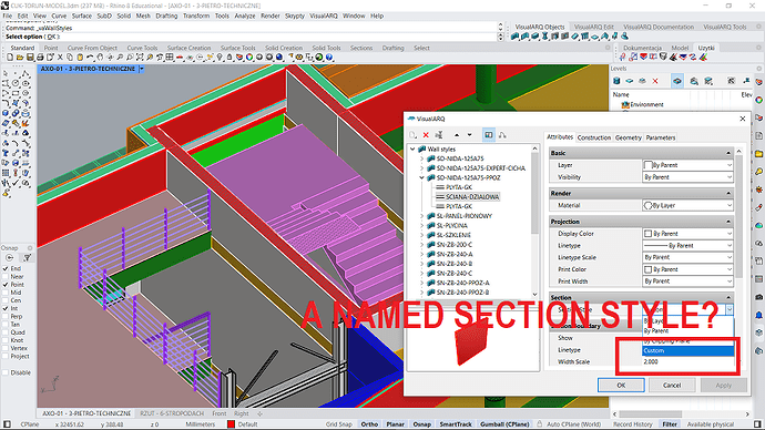

And, by the way, another idea: would it be possible to add a named section style? Such option would greatly simplify and make more convenient changing and maintaing drawings:

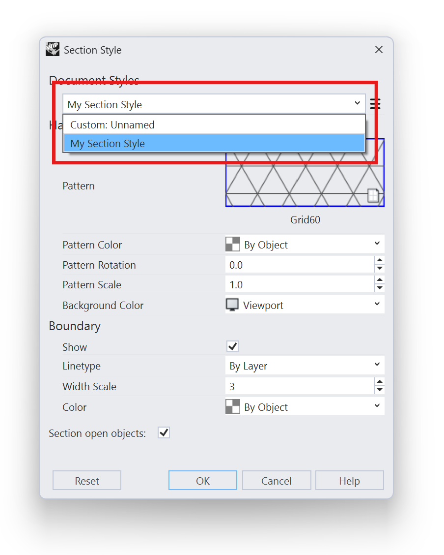

This is indeed a planned feature for Rhino 9. If you’re interested, you can already try it in Rhino WIP:
However, please note that there’s no public VisualARQ version available for it yet.

@jerry.bakowski We can study the option to flip slabs. But it’s not that common as with walls, since the slabs usually have a top surface and a bottom, with distinguished layers, while walls define their interior and exterior side depending on the direction of their path, which is something that can be mistaken easily.
On the other hand, walls and slabs intersect automatically. If they have the same section styles, their intersection line will hide. So right now, for this particular case, you would just need 2 slab styles and 1 wall style.
Isn’t that working for you?.

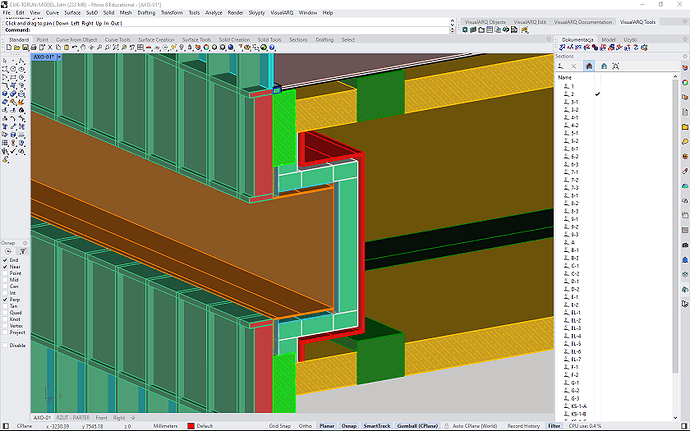

Hello Francesc,
Well, it is not :wink: Take a look, two slabs and a wall:
