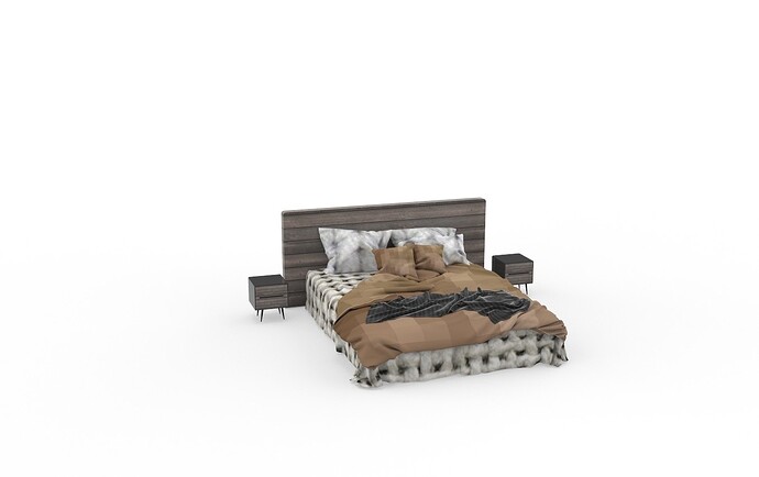

Not sure if the following is coming from AMD (the plugin code you implement) or something Rhino is doing? Only tested on Mac OS and one workstation, though I see the issue across multiple different .3dm files/models I’ve tried.
When rendering with a ‘white studio’ and a ground plane for shadows, a gray line runs across the render, which appears to be the edge of the Rendering Pnl produced ground plane. (If I rotate the model, the line moves its location up or down.)
@nathanletwory is correct. This is the ground plane causing the issue. The reason is ProRender and Rhino don’t understand the ground plane the same way. I suggest you disable the Rhino ground plane and add a surface object below your chair large enough for the shadow. Then assign the surface the ProRender Shadow Catcher material.
