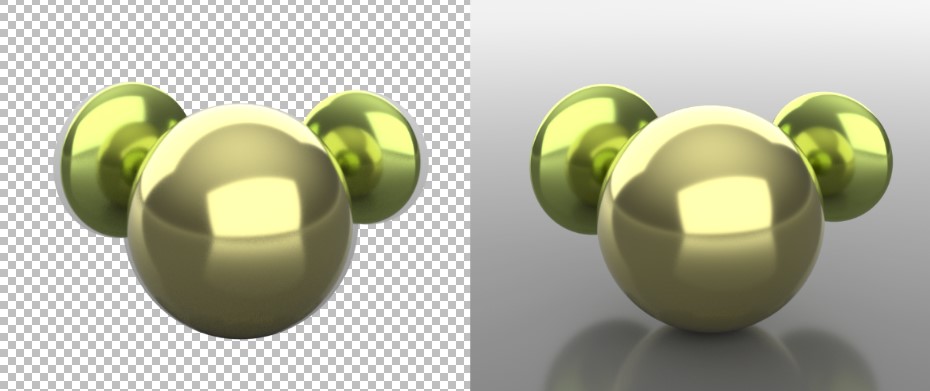

Ideally I’d like to be able to use these buttons to show the Alpha Mask and the RGBA Channel image.
Presently I am doing some manual screen capturing/masking and bitmap merging on the side, but I’d like to be able to do this the right way, and use the appropriate buttons in the Render Window.

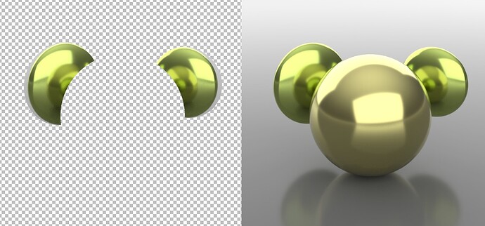

Is there currently any way to assign material specific alpha mask values that would produce this kind of cutout result with a cycles render? Any info would be great.
The first alpha button on the render output window as shown in the original post is for showing the final result with alpha visible. And the alpha channel button should also work, it would show the alpha channel only.
I do understand that the holdout materials would be needed to create the holes, and we don’t have those materials yet, which is fine. I also understand that those buttons do work, and they toggle the appropriate channels on and off, which is good.
Currently I am making the alpha mask my self and merging the images post-render; however, I would like to know if there is a way for me to programatically access the active render window and activate an alpha channel and inject the alpha mask, so that these buttons would behave as intended, and show the appropriate channels when clicked.
I know the RenderWindow class has some methods like AddChannel() and SetRGBAChannelColors() that seem like they would allow me to do this. If you have an example code or information on how I can do that, that would be fantastic.
