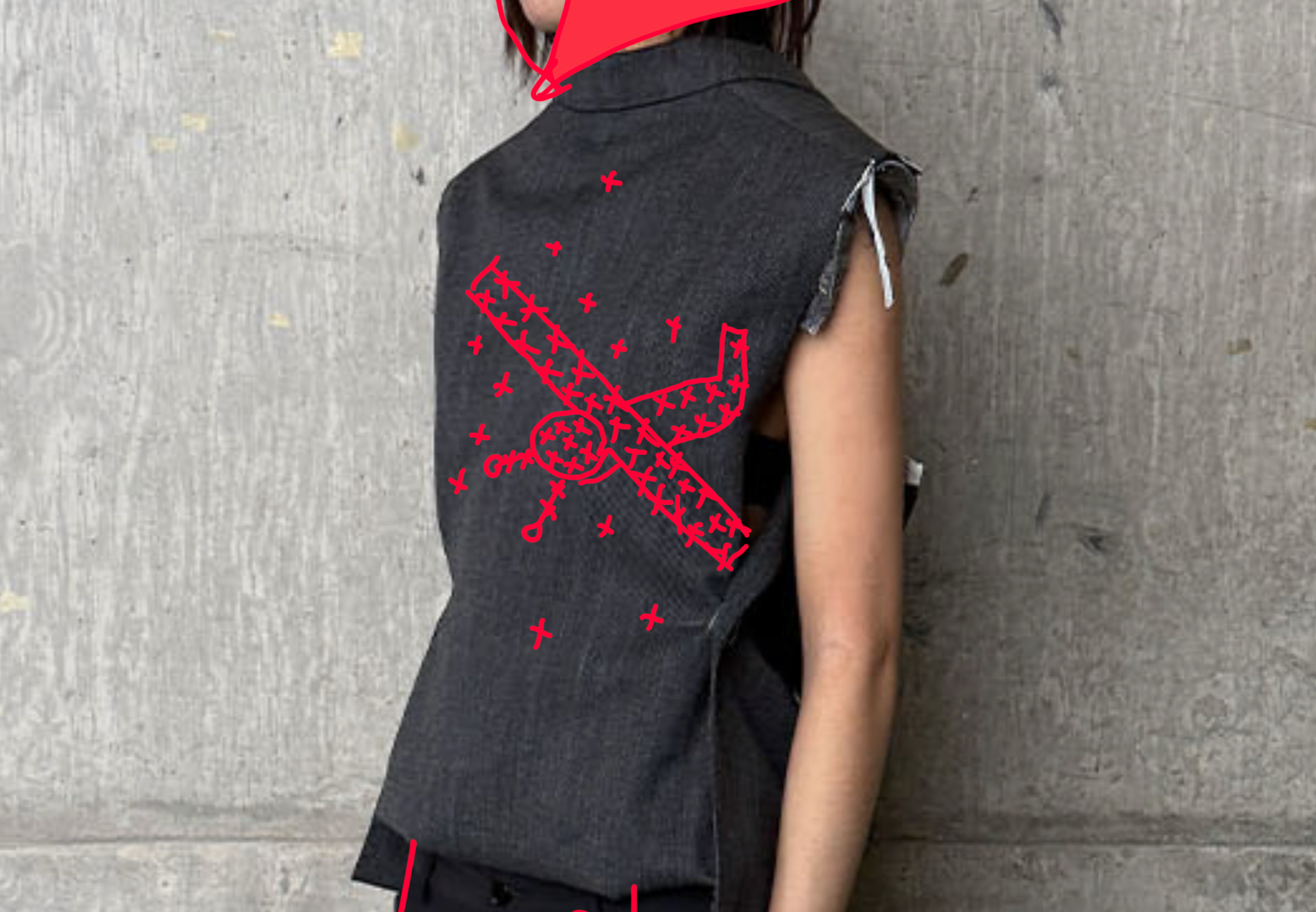

I am a fashion designer and I have these “x” shaped staples that hold the fabric together. I’d like to use them to form a larger image on a garment. The size of the buttons cannot change, but their proximity to each other can.
My original plan was to create a set of points based on light and dark values of my image and then convert these points to attractors and setting a population of points that can be moved closer to the attractors using weighted average distance between points and attractors. This is proving difficult because I’m having trouble creating the points from the original image that then need to be converted into attractor points.
If anyone has any other advice that would be amazing. Thank you!
