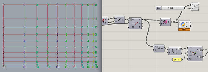

point list only give list sequence of the first tree? if there is list within list [ [a,b,c], [d,e,f] ] if does not tell the secondary list sequence. Maybe I was wrong?
If you pass a DataTree to the Point List component, it displays each branch in a different color.
(Used grasshopper file from one of your other questions)
Q_python in GH_v3.gh (14.9 KB)
-Kevin

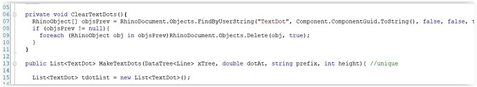

For some sort of “general” approach … try to translate the attached (there’s no auto C# to P conversion):
TextDot_entryLevel_V1.gh (116.1 KB)
For some sort of “dynamic” solution the most important part is how to remove the previous Dots (say: in cases where many colors, heights and the likes are used).
