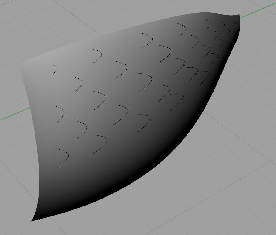

Hello all,
I would like to add smooth fish scales to a surface.
What would be the best way of doing that (running Tsplines demo right now, will that be a good way)?
I played with some curves projected onto the surface, extruded etcetera, but I am going in circles.
Many thanks, Robert

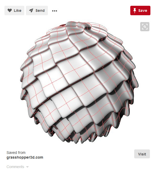

I saw this today while looking for something totally unrelated, but though it might help:
Andy
Hi Robert - probably I’d make one of these objects flat, in the CPLane, array them on a planar surface, then FlowAlongSrf to get them up onto the curved surface.
What about a texture map and then using displacement? It might be the quickest way.
Displacement geometry affects the render mesh, so you do have to extract that mesh if you’re going to prototype and need the physical surface relief in the STL.
Oh how great, thank you for that.
I peeked at it a while ago but did not make a connection with what I want to do now.
Something new to study :wink:
Kind regards, Robert
