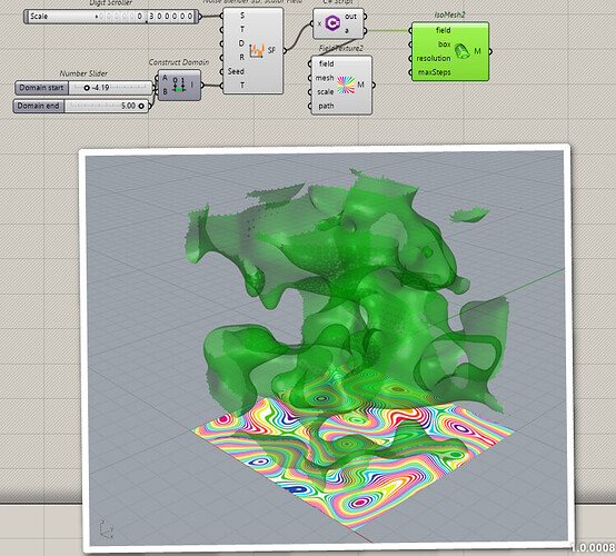

Playing with Iso Pod and some of my scalar fields
WIth a torus
Add some noise from Nautilus, in order to have the good amount of noise the new scalar field component have a domain output when possible. Noise is added using field sum
A lot of new possibilities, different from just some bump
In this video I keep the biggest mesh object, so indeed mesh is eroding but doesn’t disappear.
